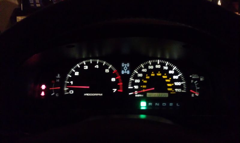

J judoant Member Apr 12, 2012 #1 Got the super white LED guage cluster swap complete. Used the Tri-Power 3LED Bulbs. The twist lock socket required some tightening of the contacts inside to make solid contact but it worked out nicely. Attachments IMAG0763.jpg 44.5 KB · Views: 789

J judoant Member Apr 13, 2012 #6 If I could change anything I would have gone with the Matrix 5LED Bulb. I did not think I had enough depth to accommodate a longer bulb but I have plenty of clearance.
