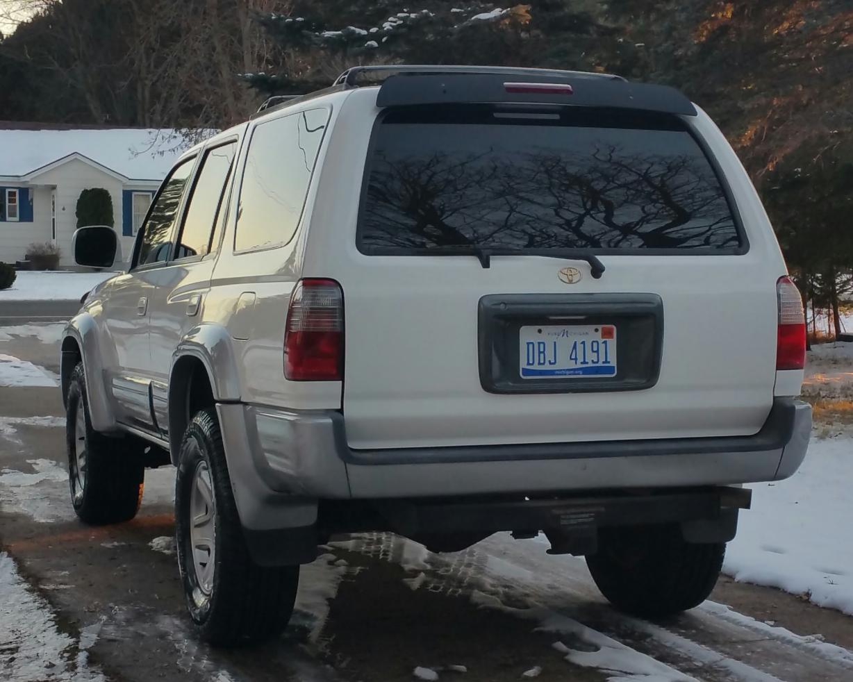

I got my 2000 last October and the paint had been neglected. The finish was dull, chalky, and the liftgate in particular was horrible. A lot of contaminants impregnated in the finish.
I removed all badges and emblems from the paint (except for the one gold emblmem on the liftgate), went over the whole body and cladding with two clay bars, using a variable speed polisher I rubbed it out with Meguiars fine cut compound, followed by Meguiars swirl remover, and finished with Wolfgang's Deep Gloss Paint Sealant 3.0. The finish turned out excellent! It wasn't fun and it was messy but it was worth it.
I've used Collinite 845 insulator wax which is really good but I think I like the Wolfgang's DGPS 3.O better and it's highly regarded. It's a little bit easier to work with and I think it will last and protect better through the winter.
I recommend checking out www.autogeek.net for auto detailing supplies.
This picture shows the high gloss of the rejuvenated old paint but nevermind the hot rod slant. At the time I had just installed the rear lift. A guy I work with passed me one day after leaving work and he said it was the whitest vehicle had ever seen.
