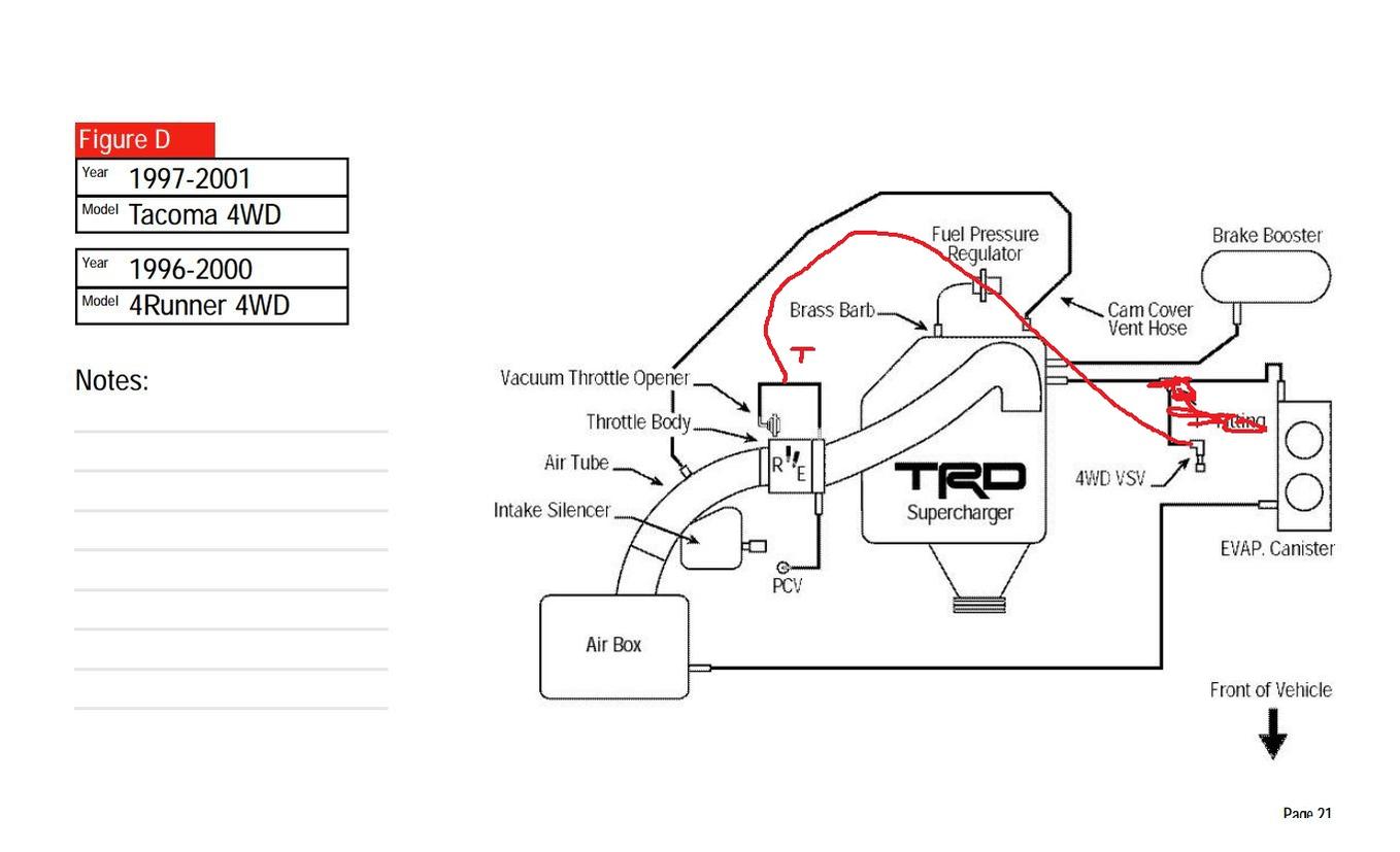

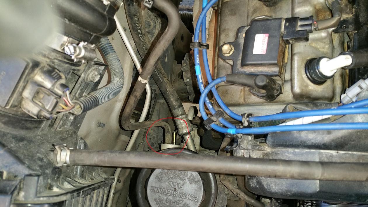

Hey, I just installed a supercharger on to my 4runner and have 2 questions about vacuum routing as the instructions were not the clearest.
power steering vacuum lines, 1 went to the intake tube where should the other go, before the supercharger it want to the intake plenum.
When I turn the engine idles lower instead of higher.
The 4wd vsv I teed into the vacuum throttle opener as I didn't have the right size T to go into the larger evap canister line.
Will this cause problems?

I don't see the vsv being an issue at all and I believe on the 1st gen sc's its that way anyways.
I dont know about that power steering line though. I didnt mess with that one.
Thanks
Gadget helped me out, he said:"The power steering idle up goes to the big EVAP hose. Do not cut into you brake booster line."
