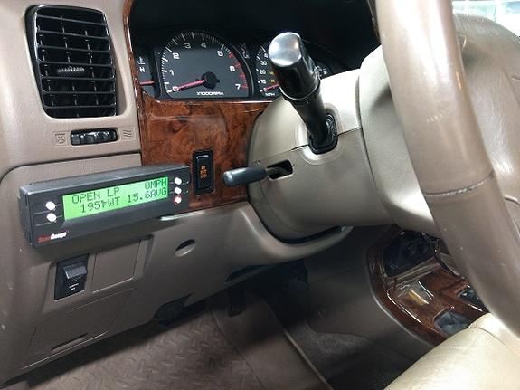

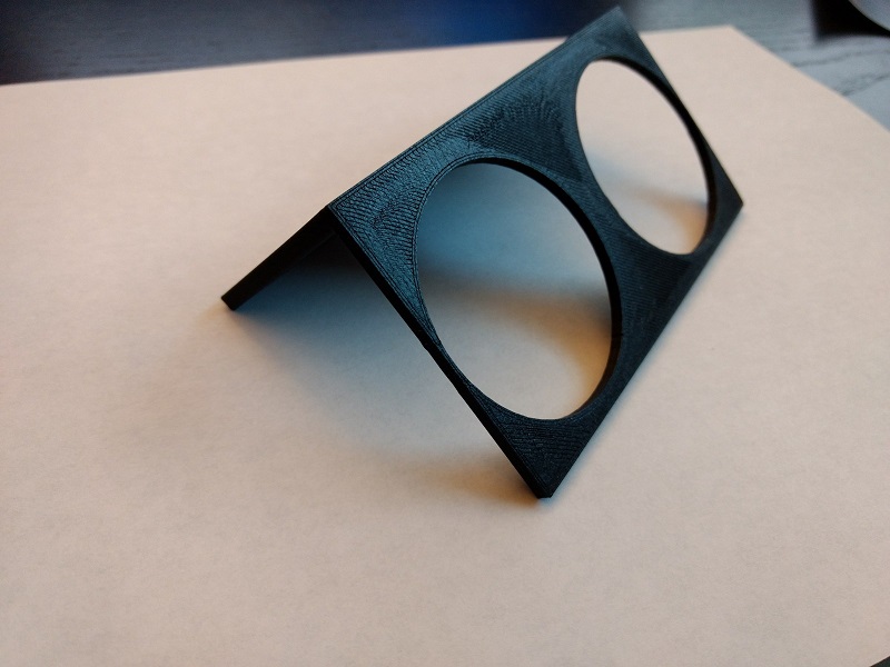

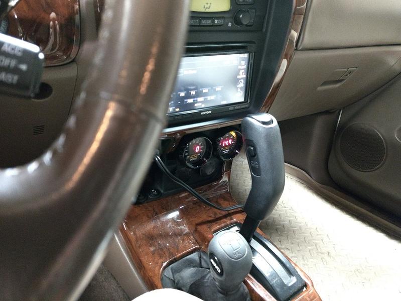

After installing the SC last weekend, I needed to find a place for my scangauge and also my boost and AFR gauges. I ended up 3D printing a bracket that replaced the ashtray. Since I opted for digital gauges, the readouts are perfect and also aren't in my sight lines like they would have been if they were on the A Pillar. The Scangauge I just attached to one of the switch fills so it's still easy to move around.

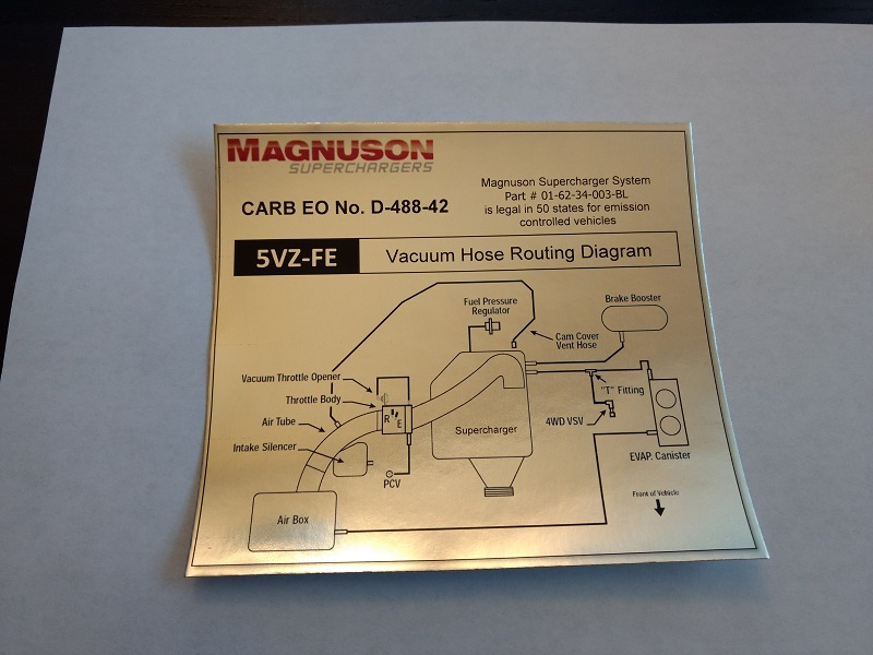

Being in CA, I also wanted to have a CARB sticker for it, but couldn't find one, so I made one to replace the stock Vacuum Line Sticker under the hood. I used silver foil labels and it turned out perfectly!

I like everything...except your vacuum sticker.
I produce ones that look stock with mag/TRD's image as an influence if anyone is interested. Shameless plug I know...

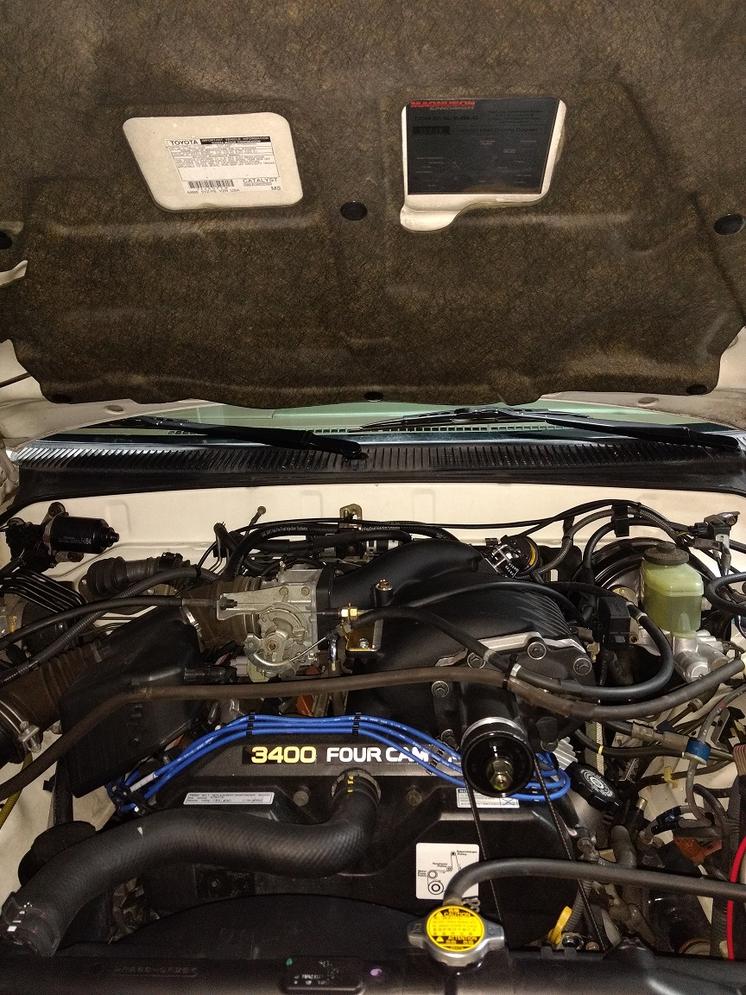

Obligatory Engine Bay pic with label and supercharger.
PS-I recently power washed that engine, so it doesn't usually look that clean, but I felt it was appropriate to make room for the SC. It was pretty muddy before I did that though, I don't think it had been touched in 18 years!

Haha! That would have come in handy, what did you end up printing it on? I chose silver foil so it can withstand weather/water. But more importantly, I needed the CARB sticker and there would have been no way to fit both (vacuum and a decent CARB label) in that spot without redoing them both.

Oh cool! Yeah I'm a super novice with computers and printing but what I do works. I use shipping labels (stickers) and then laminate. Mine have lasted a long time so far. I reproduced my emissions sticker to include CARB numbers as well as engine swap bar coding and such. Bar codes actually scan too
