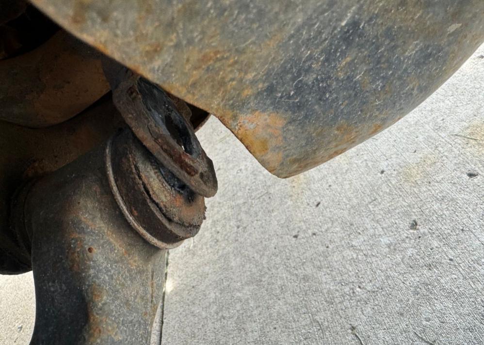

My SuperPro LCA bolt failed while driving a couple weeks ago. I noticed the truck was driving like garbage, and made an assumption that my wheel bearing was on it's way out. Once I got home and inspected the truck, I found this:

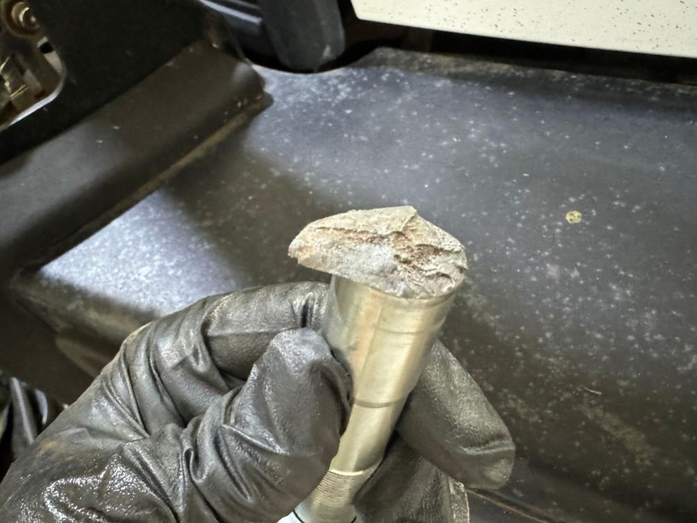

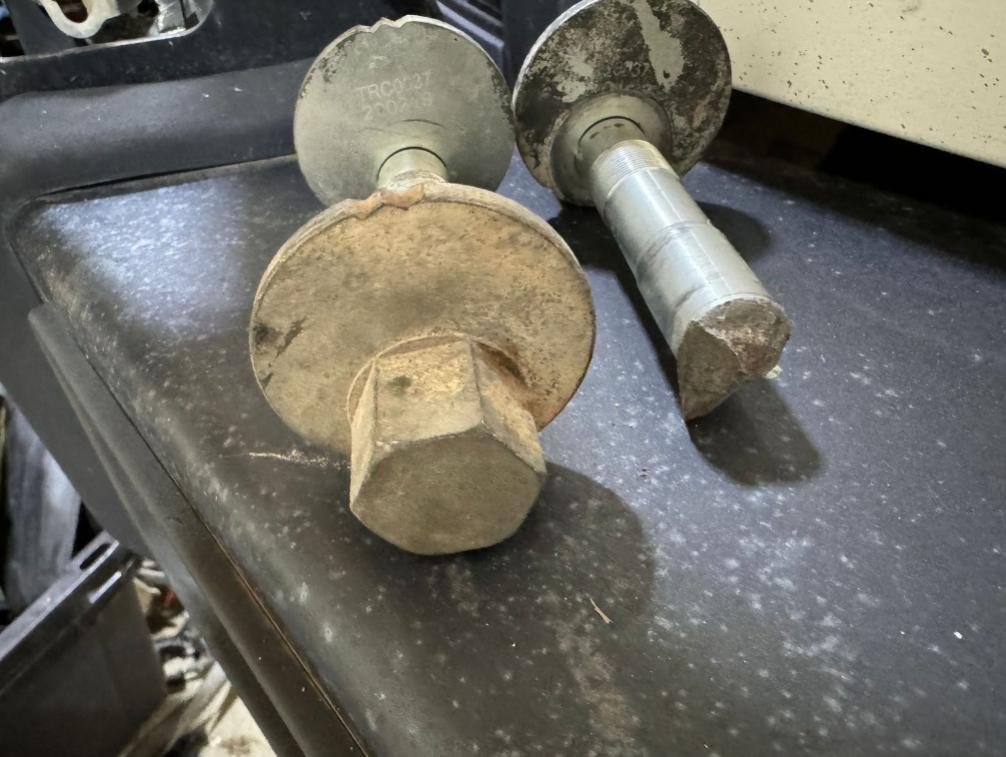

I tore it down and found out the SuperPro alignment bolt had failed, and was holding on by a nub.
attachment.php
attachment.php
This set of LCA's have been installed for a couple years, and the alignment bolts haven't been touched since I installed them. The truck hasn't been offroad in about a year, and there was no hard hit to the suspension to cause this.
I emailed the SuperPro warranty line when I found the failure, but they still haven't responded.
-Rob
