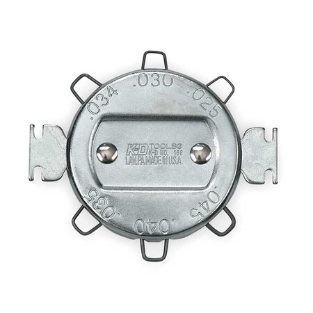

You need one of these to set the gap on dual element plugs. Don't use a normal flat blade type--only the wire type in the pic. If .045 won't pass and .040 will, you are good to go. Like thor99, I use an 18" inch length of 5/8" inch fuel hose to thread the plugs. Makes it almost impossible to cross-thread.
What's the difference?
Because the ground electrode has a concave shape on the end to maintain an equal distance from the side of the round center pin, the flat blade can't measure the distance accurately. The wire can slide through the curved gap.
