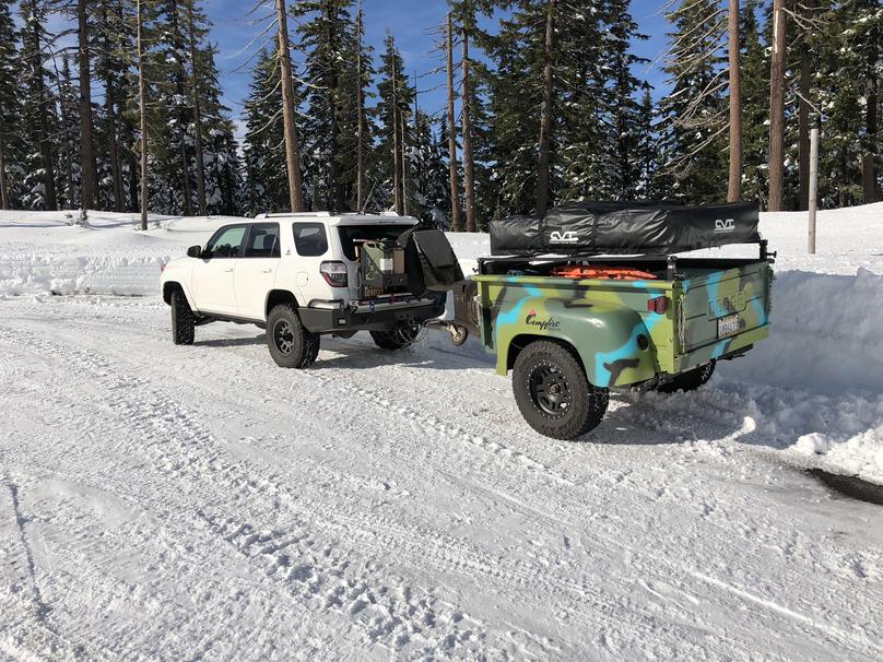

I have a 1200-1400# Off road trailer that I built. I wish to tow it across the country on various remote trails, etc.

Said trailer:

Said trailer:

Love the trailer. But I am biased, cuz I built it. :thumb3:

I tow a similar, but much uglier, trailer with mine and I run Icon. Honestly, I think any of the lift options will all be about the same, relitive to towing a trailer. unless you add a bumper, drawers, fridge and other crap in the back of the 4Runner, cans, etc. you most likely won’t even need an “over-load” spring. I run a heavy spring in the rear, but I’m pretty loaded down.
