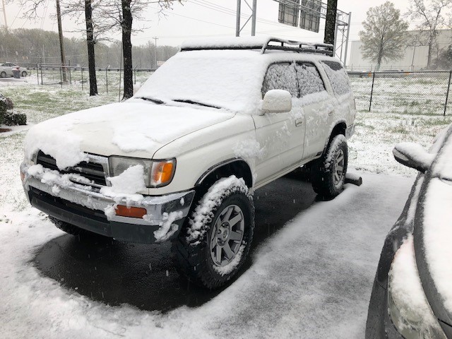

Looking into option 4. How has option 4 treated you? Any photos to share?
This has treated me great. My wife loves the ride. It performs great on trails. We did the first 2 miles of the Rubicon this past summer and it handled everything just fine. (Only the first 2 miles as it was still snowed in past that point.)
Picture was just this evening.

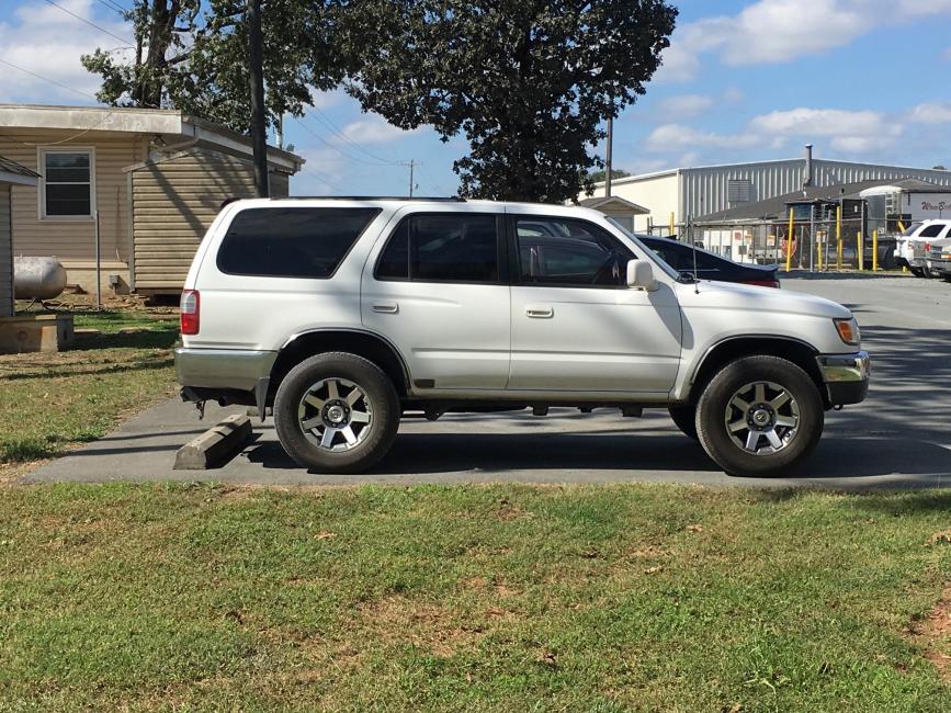

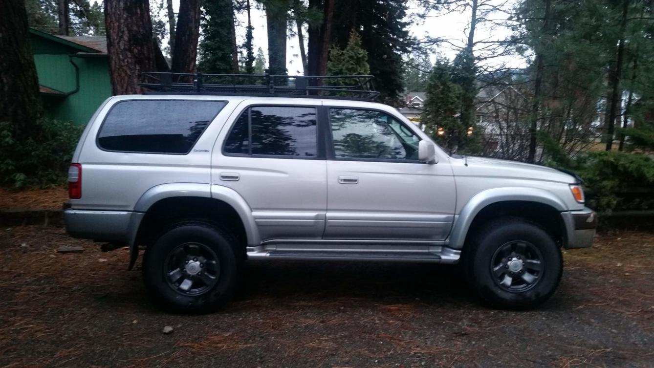

Any center of rim to fender measurements?
Thanks!
Before and after. I don't have hub to fender but I do have ground to fender with the same tires before and 10 days after the lift.
Front was 34.5 and then 37.5 inches
Rear was 35.25 and then 39.25 inches
Both have settled I would say 1/2 inch in 3 years.
