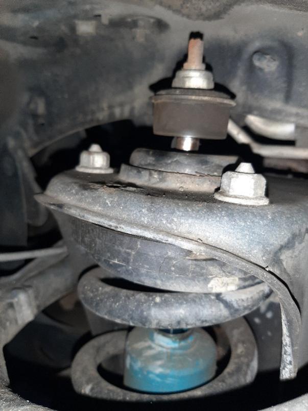

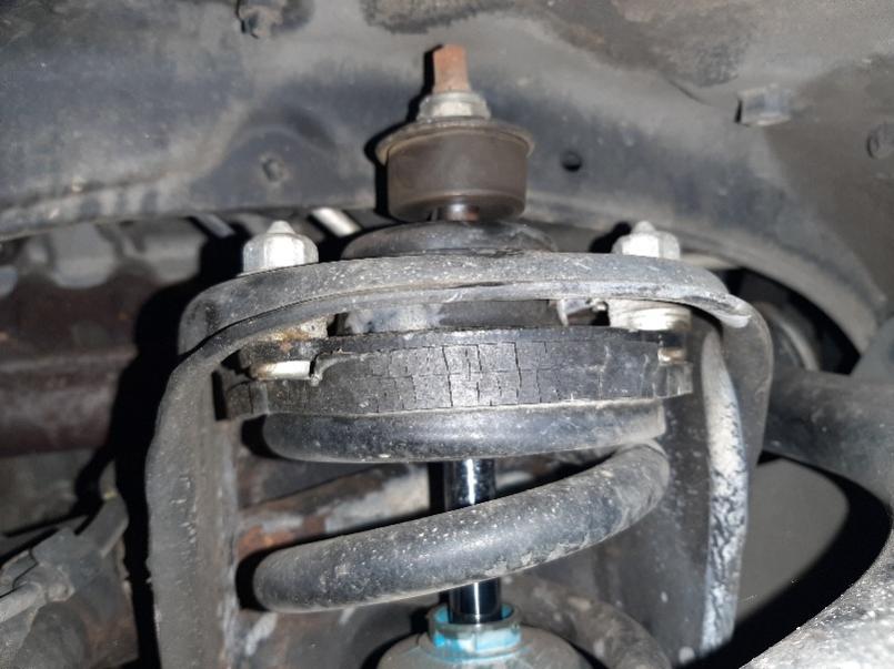

Hello all. I'm new to the 4R forums, so please forgive me if I'm not following the posting protocol. I saw this thread, and thought I might get some advice from more knowledgeable 4R owners. I have an 07 4R Sport w 178K. It's in good shape. However, the previous owner tried to level it, and I'm pretty sure it needs to be fixed. The front passenger side appears to have been raised a bit, but whomever did it used what looks to be regular spacers, I mean penny sized spacers under each stud on the shock mount. See pics. What appears to be happening now is that the not of the strut doesn't seat correctly, and I get a loud clunking sound whenever I go over a bump or dip. Would appreciate any insight the group may have.

Hmmmm, well your knock over bumps is obvious, the shock is not secured properly. My only suggestion at this point is to disassemble the shock/spring assembly using the " no spring compressor" method, remove the washers being used as the "lift" and make sure there is a rubber bushing on the bottom side of the top hat where the shock stem goes through. So as you assemble shock the stem should go through a bushing, then the top hat, then the upper bushing, as you have, washer and nut.
