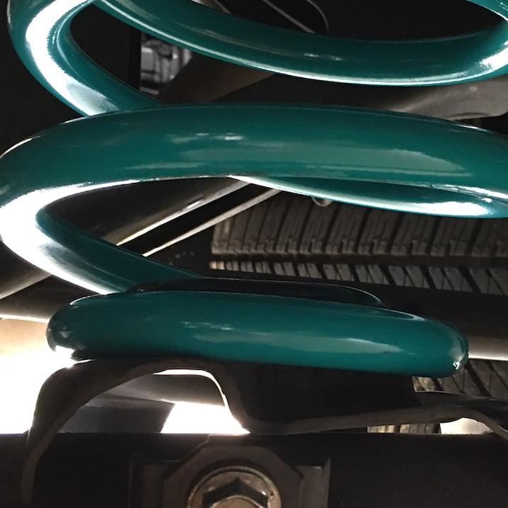

I would suggest you check and make sure the rear coil springs were installed correctly. Many have installed them without clocking them correctly into the lower coil seat step, as shown in this photo. That easily gives 1/2" more lift than it's supposed to.
Yeah, and coils shouldn't settle too much, maybe 5mm, 10mm at the most, but 5mm is kind of common after the stress from the powder coat process is "worn out of it".

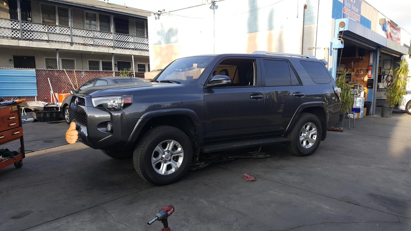

Just installed my 6112 today at the 4/2 setting. Pre install lowest point of fender to floor messured 33 1/2 inches. Post install and after driving 12 miles lowest point of fender to floor messured 35 1/2 inches. I didnt have enough time to grab washers to install the sway bar drop but runner is driving fine all the way up to 80mph no issues, no alignment yet either. *picture shows suspension unsettled*:smow:
got any more pics?
