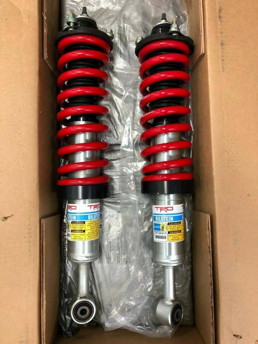

the factory has 2 slightly different size oem springs to compensate the weight, (driver, gas tank, etc). If you swap those w/ aftermarkets then you may have a slight lean. You could set the drivers side up 1 clip. Take a look at this pic of the trd pro Bilstein kit. The one on the right is the drivers side (LF). It's up 1 notch. Anther option is a small spacer above the top hat, same effect. Hope this makes sense.

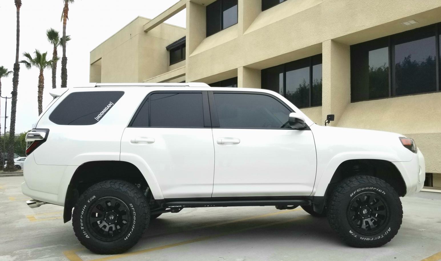

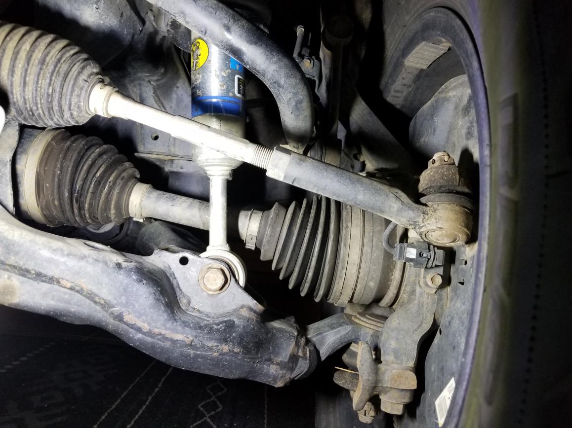

I have the Toytec HD 2.5" lift coils (TT 521600) in fronts with 1/2" thick strut top plate spacer on driver side & 1/4" thick spacer on pass side. I HAD my front Bilstein 5100's originally set to the very bottom "0" lift option for the first year of the lift & it seemed fine. I did notice a little settling in of the springs & decided to see how the second clip 0.85" setting would look & it bumped the lift right back up to where it sat day 1 of the lift. It rides fine (I am very happy with it). Very little nose dive when braking. It doesn't ride like a kushy SUV or Cadillac, but more like a truck with a little lift - go figure. Also, my CV joint angles look exactly the same as they did day 1 of the lift. Here's a side shot with this setup + my CV boots:

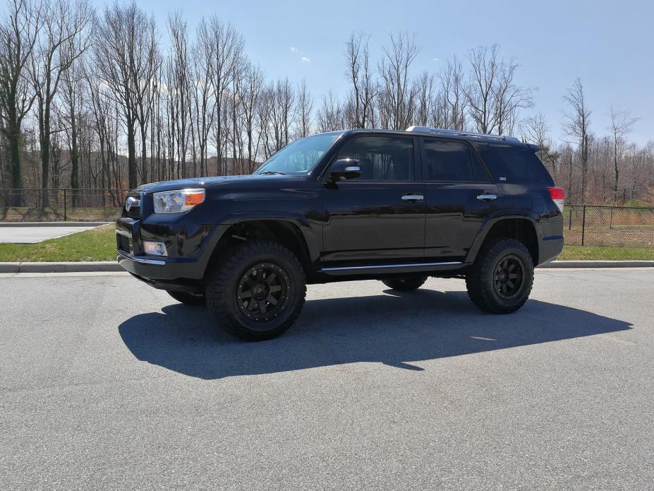

Well, I got everything installed and I have to say it looks pretty good. I cant tell that there is any lean at all, so if I cant tell I'm just not going to concern myself with it.
