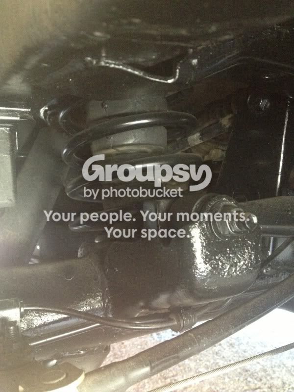

oh I KNOW THIS!!!
Whats happening is your springs have weakened over the years and the rear end has slowly settled down to its self resting on the inner spring cone supports. (not actual bump stops that are attached to the frame.
I have a picture of mine that was the exact same problem before i put my 3" lift on. here is the picture...
