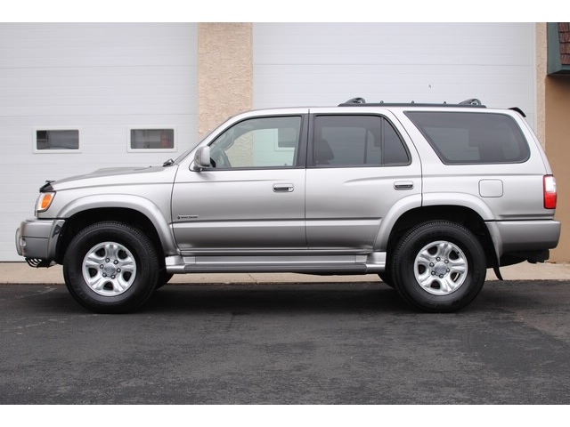

Go with stock suspension for a 2002. Thats the lowest sitting suspension for a 3rd gen. Heres a random shot of a 2002. I cant imagine you would want to go any lower than that.

Yes I want to go lower than stock, I would like to maybe 2 or 3 inches lower than stock.
You will probably be ridding on the bump stops on all 4 corners. This chassis was designed for ground clearance and not really to be lowered. So without doing a lot of work it wont be done easily.
