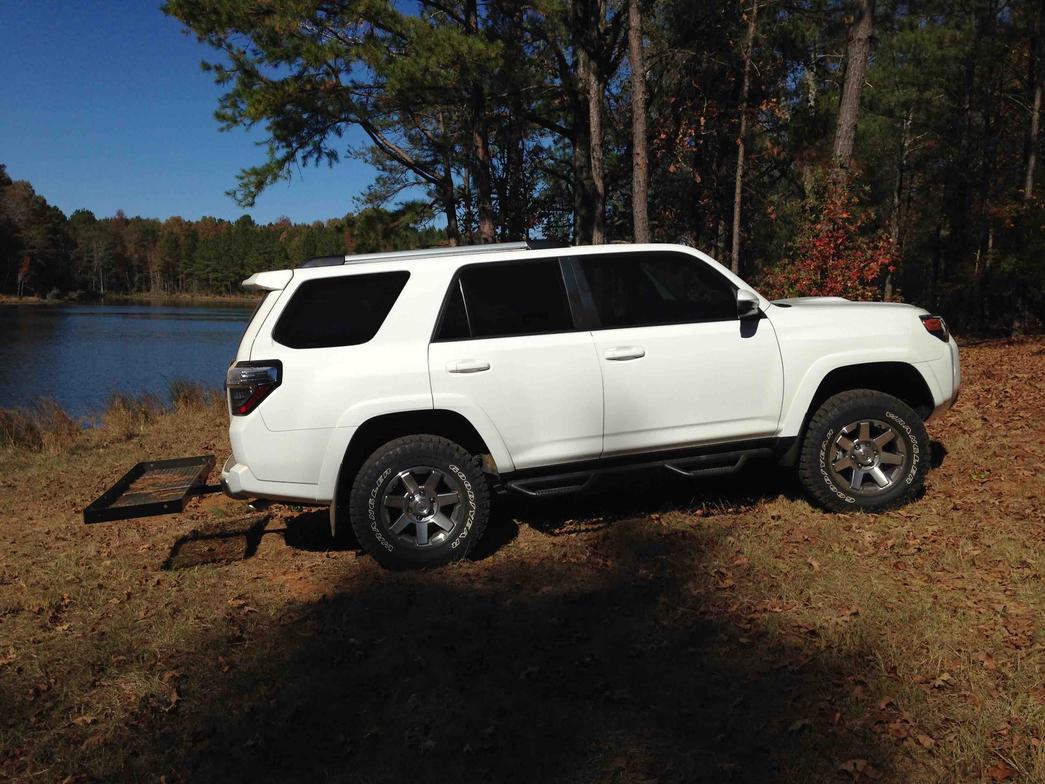

My off-roading is 420 miles from the house, so lots of highway miles. I'm running 5100s front and rear. 2.5" up front and 2.0" Cornfed spacers in the rear. I had Camburg BJ UCAs installed up front so that the alignment would be excellent and it is. The ride is awesome. No more brake dive or corner sway. Firm yet smooth. I have approx. 4,000 miles on this lift and so far so good.
