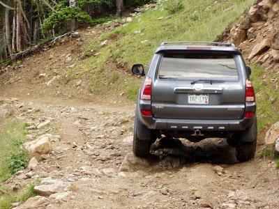

This is 4-wheeling:
This is rock crawling:
