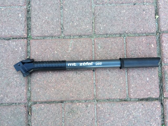

I use a 20 year old frame mount barrel style bike pump
2 strokes per lb. Get a pump rebuild kit.
Air pump.
You may want one of these small powered air pumps: CyclePump. Small, well built, etc.
