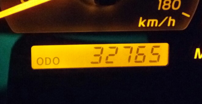

32K mi?? Wow!
Well ... I put a few miles on it. :)
