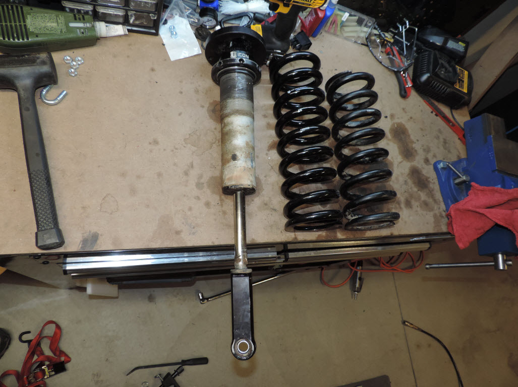

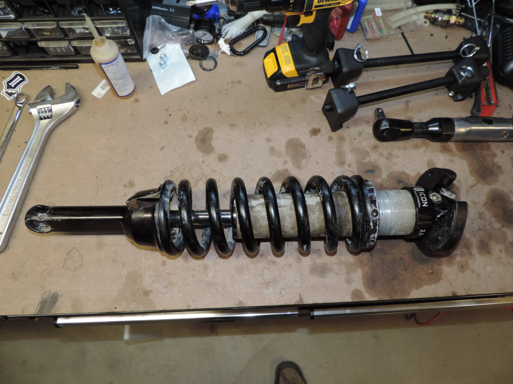

I spoke to Icon yesterday about this because I am looking to add a bumper. They said it is just a standard coil swap.
If you look at the coilover it's definitely not. At least not how I've usually done it in the past (ie: remove a retaining nut and top cap).
In terms of swapping coils on 2.5 coilovers it's a standard swap over, same as any other brands.
You're going to need something like a $700+ Branick 7600 wall mount spring compressor, or some metal fab and a press.
You can get the 12" 650 spring off easy enough, but you'll have to compress the 14" 700lb spring several inches to install the retainer. The 3" spring around a 2.5" shock means not enough room for most spring compressors to work.
You need to compress the spring far enough for the spring to get over the spring seat, which goes inside the coil to about the height of one coil, if that makes sense. You can see the internal lip inside the spring in this picture
I'm pretty lucky as the shop I work in has a wall mounted spring compressor!
