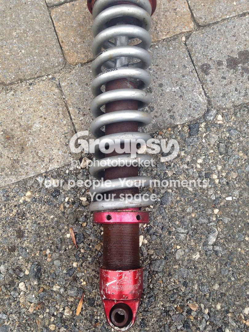

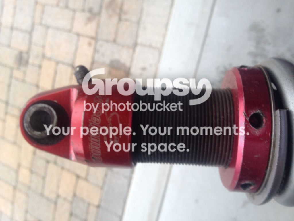

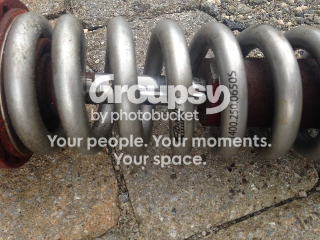

So forgive my ignorance or flame away as I'm new to the 4Runner world, actually picking up a 99 limited w/ elocker next Friday and driving back to Connecticut; but I'm looking for a few answers regarding some used SAWS front coilovers I found locally for just over $200 bucks and want to ensure they'll work.
The seller gave me the following info:
-pulled off a 2002 trd Tacoma
-650 eibach springs replaced in November 2014
-race runner shocks
-one shock needs a rebuild
-comes with two rebuild kits (basically o ring set, no oil)
-I looked at a few suspension sites and it looks like this gen Tacoma is compatible with the 3rd gen 4Runner suspension, true?

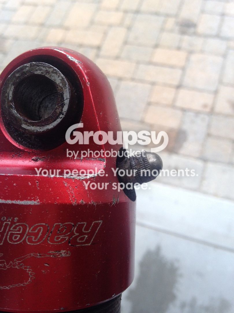

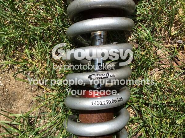

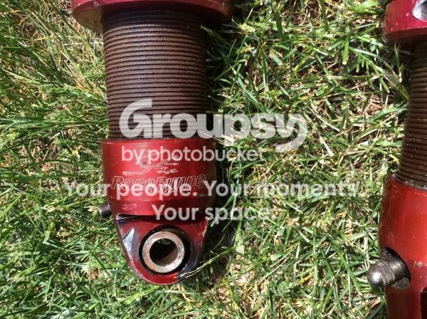

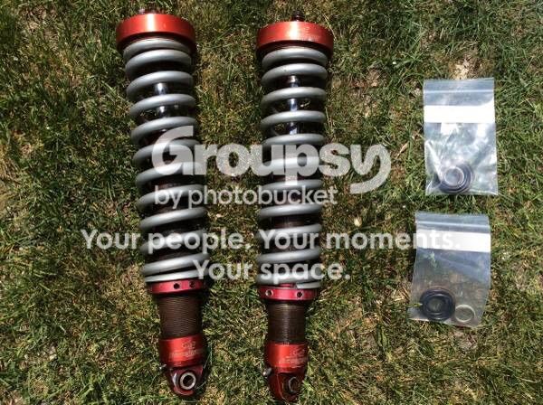

-SAWS owners, anything missing or needed based on the photos below?
-Worth $200??
Originally I was planning the the tundra/5100/lc setup until I came across these

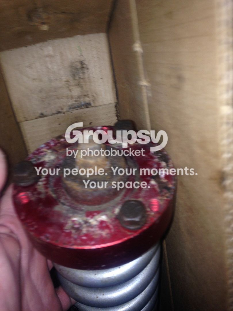

Nothing is missing, and they'll bolt right up. There's debate as to whether the top mounting plate being clocked 15 degrees off (to fit a tacoma) matters, but I am of the opinion that it doesn't.
Those are the SAW 2.0s. Nice coilovers for sure, especially at that price.

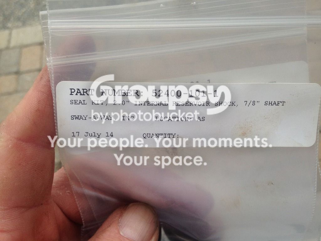

You can look up guides to rebuild if you're pretty handy. Will save you about $150.
I see nothing missing.
These look like the older SAWs off my Tundra. The top mounts have no heim joint, he can simply spin the mount (loosen the height adjuster first to remove spring tension/preload) to line up the the bolts.
They look complete,can't tell by the pics if the 3 top mount bolts there but they can easily be sourced. I agree with JBurt, $200 is a hell of a deal.
Agreed..
These are the older version 2.0" bodies. Still good co's. I would definitely buy them for that price and I highly suggest doing for a full rebuild on both. Condition is probably unknown and they're old. Id look into eyelet bearing (uniball) replacements, new seals, oil, and nitrogen refill for sure + whatever else that might look worn out when they're apart. Do it now before you go throwing them on cus I know it's tempting lol.
