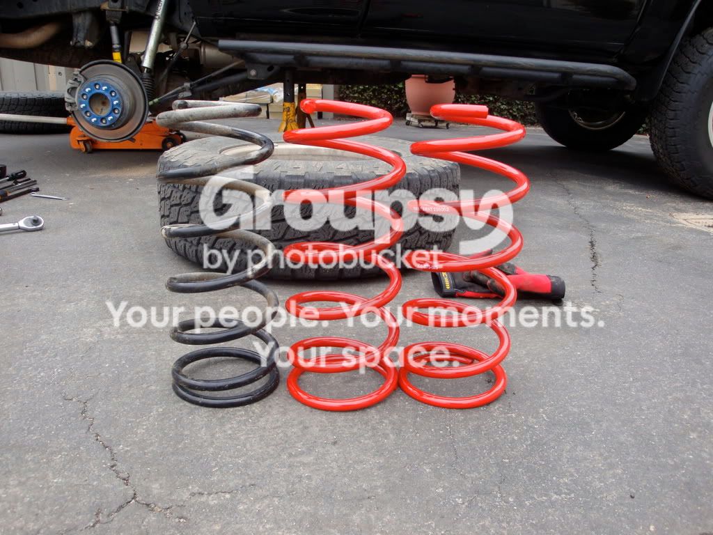

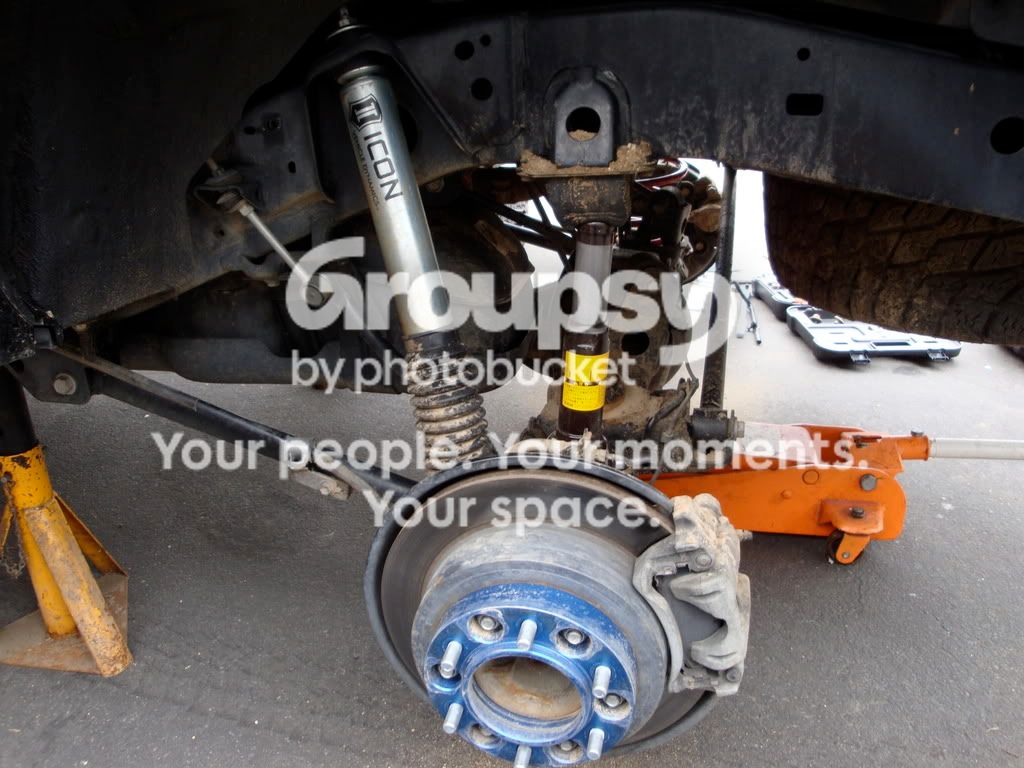

I found the Icons to be much too stiff, so today I installed SAW coils. I kept the icon shocks for now, as they do just fine. Install took about an hour by myself.
The coils aren't very much different in size than the Icons
DSC00141.jpg~original
DSC00142.jpg~original

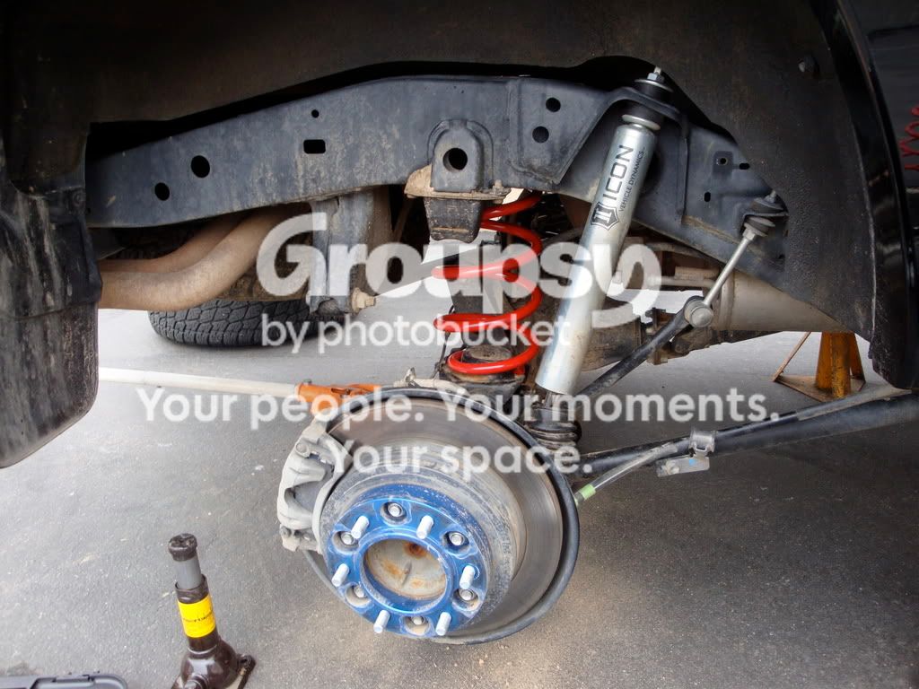

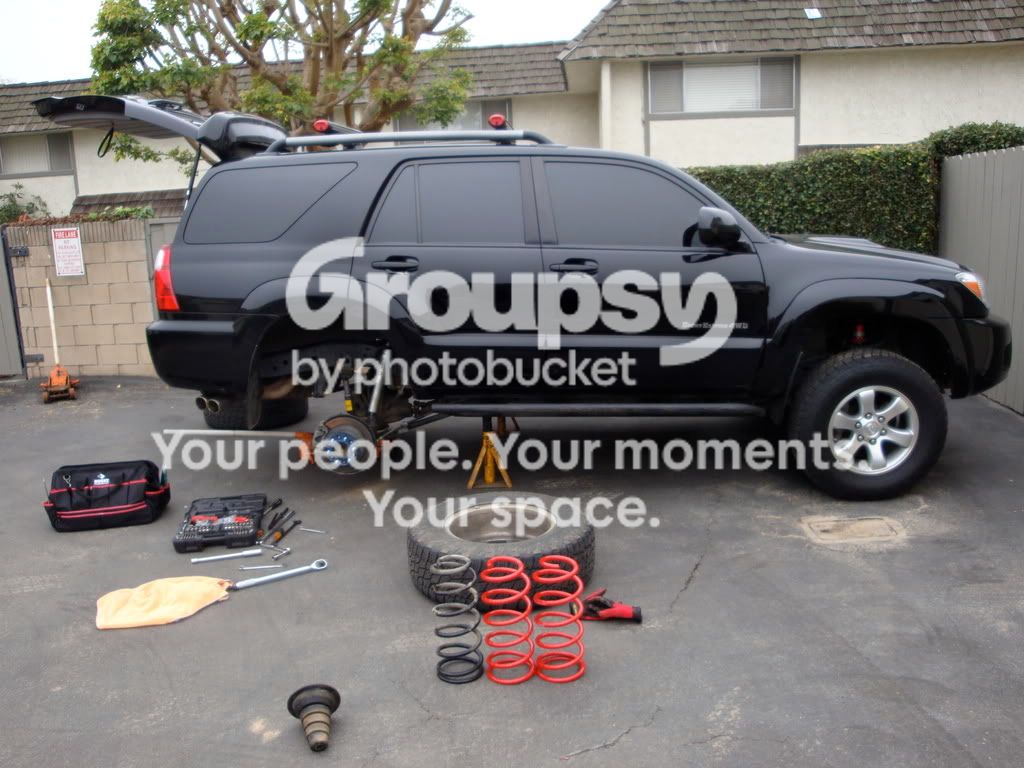

I used the bottle jack to press the axle down to get the coils in/out.
DSC00144.jpg~original
New coils in

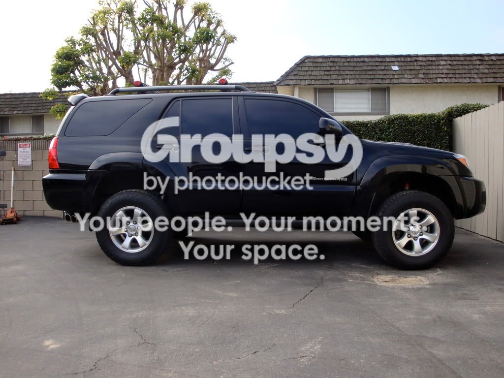

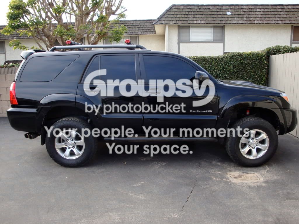

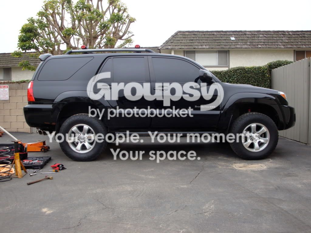

And the after shots:
DSC00146.jpg~original
DSC00147.jpg~original
DSC00148.jpg~original
First impression is that they lift slightly less (which is what I wanted) and are less stiff. I will be able to give a better review on their stiffness after driving on them for a while. As it sits now, I will probably keep the front where it is, but if the back settles too much, I'll lower the front a little.
Looks good! The stance in the 'after photo' looks perfect to me. It'll handle some gear in the back without being butt low.

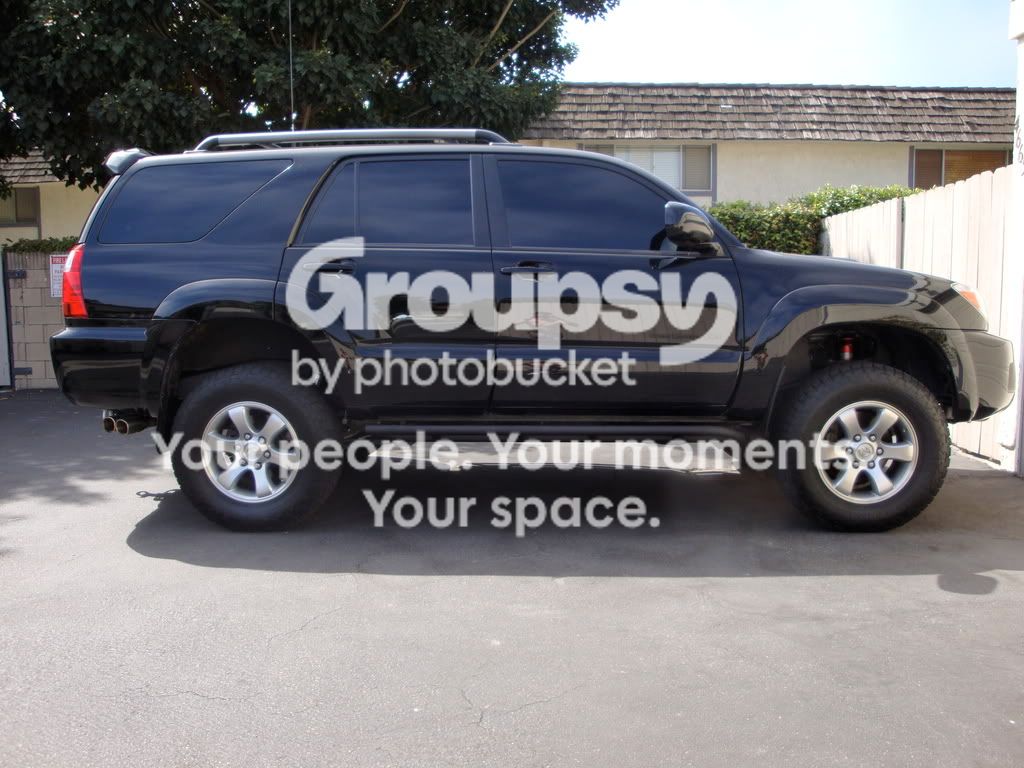

Here's a shot from my OME to Icon swap, and it looks like the SAW's look much better than the Icons did.
DSC00134.jpg~original
Good to know about the Icons. Post a long term update how you like the SAW's in the back there.
Oh btw, not to be a nanny, but you oughta have some wheels chocks up front there buddy.

Didn't have any on hand. I always have blocks of wood in my garage, but after I got everything out I couldn't find any. I wasn't about to wait for someplace to open, and re-pack everything. I took an informed risk.
