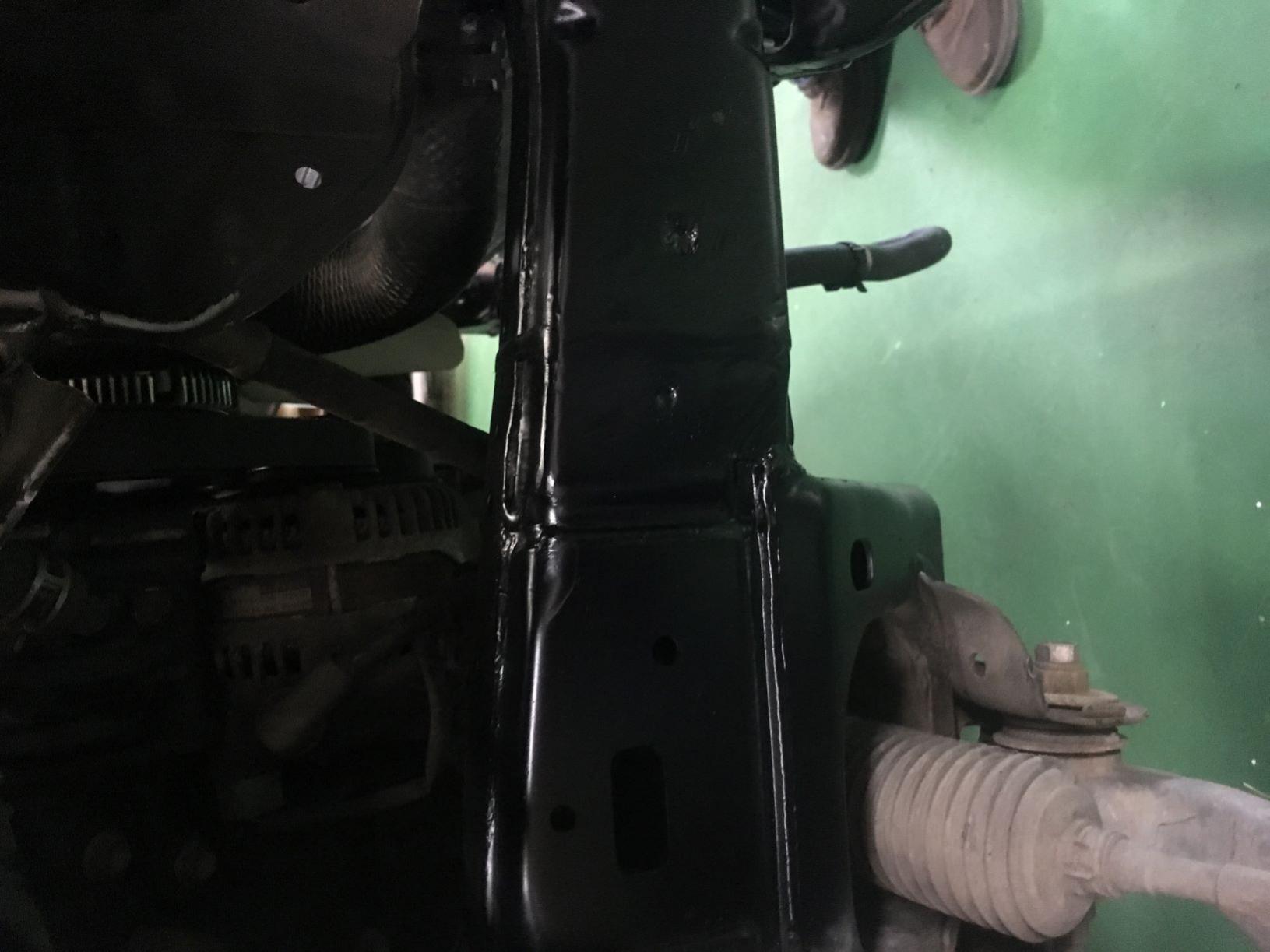

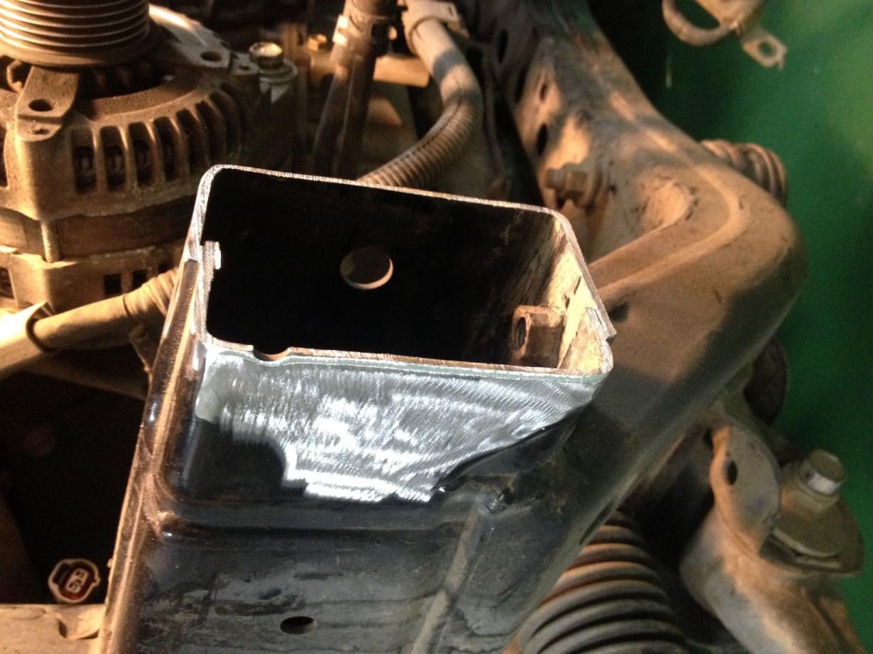

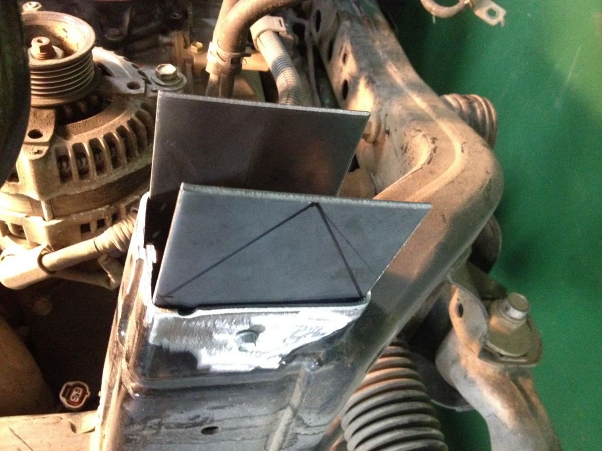

Yep here is a look inside at the front sway bar area. I made this repair on both T4R number 3 & 4. This is #4. The cut was made centered on the hole on either side of the sway bar mount. The donor pieces came from #1.
