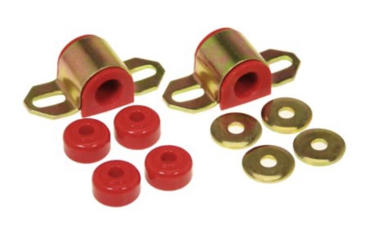

Not the end links, but the brackets that hold the sway bar bushings. Like these:
Reason - I’ve reached out to ride tech based on another member’s post to try to get front and rear replacement delrin-lined bushings with billet aluminum brackets. They typically service GM cars and trucks, so aren’t well versed in our brackets.
