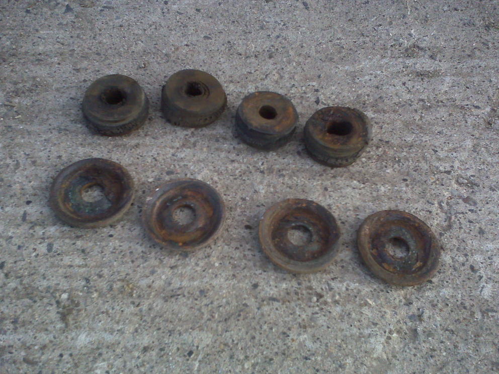

so I noticed my bushings were cracked and it hasn't snowed today (did yesterday). easy fix so finally did it this evening.
well as I took them off I noticed some rust. ok should be ok cause I bought new washers AND bushings.

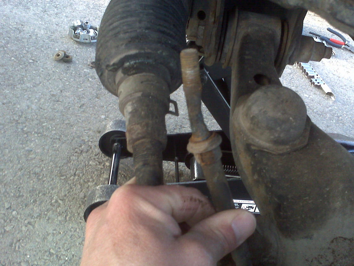

well the rod looks bent and it seems it was the item rusting.
so looking for confirmation that there bent and I have to REDO this easy task.
I hate redoing things over if I can avoid it. should have just bought new rods as I was getting bushings. dam bushings and washers were $35 what is the rod going to cost me.

I am sure there are more mastery ways or somthing. now i get to do it agian since my links are bent and rusted.
Those rods will snap eventually. Mine did on the highway and yours almost look worse. I built a set of custom rod ends for all 4 wheels that account for the lift better. I will be installing them this week.
No need to jack the truck up. The sway bar should move by hand if it's greased and torqued properly. Normal aftermarket endlinks are crap. If you are gonna get new endlinks anyways, I would get some WabFab quick discos if you're gonna spend the money. They are about the same price as OEM, they're longer (for your lift), they're quicker to remove, and they are waaaay stronger.

eh, the wabfabs may be longer, but they arent that much quicker? Ive heard several people time them and you can disco one side stock faster than you can undo both the wabfabs.
Here is a tip for the rear sway bars if you still run them. if you buy an extra set of front links they will extend the rear sway bar perfect for a 3rd gen lift. Thanks to CSL for that info.
Brian why no love for aftermarket? I'd bet my Moog endlinks against the factory endlinks any day. they are super beefy, may even be thicker than OEM.
Ill agree MOST non OEM brands are crap, I had OE (not OEM) for less than a year last time I broke a link and they were already bent up and almost broken.
