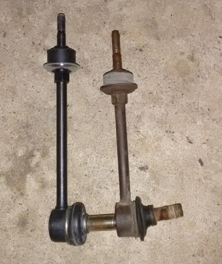

I just installed 2nd gen sway links last week, and this is what they gave me yesterday. I am running a 5100/OME lift with 896s on the rear for my added weight.
These are the PROFORGED 11310144 from rock auto (best price).
