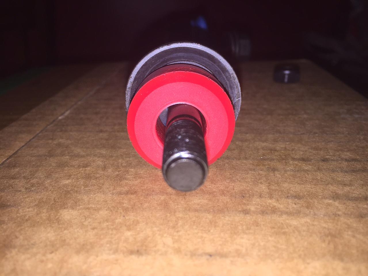

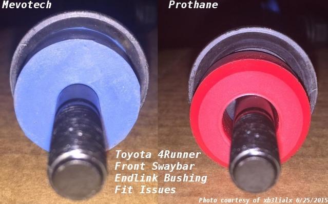

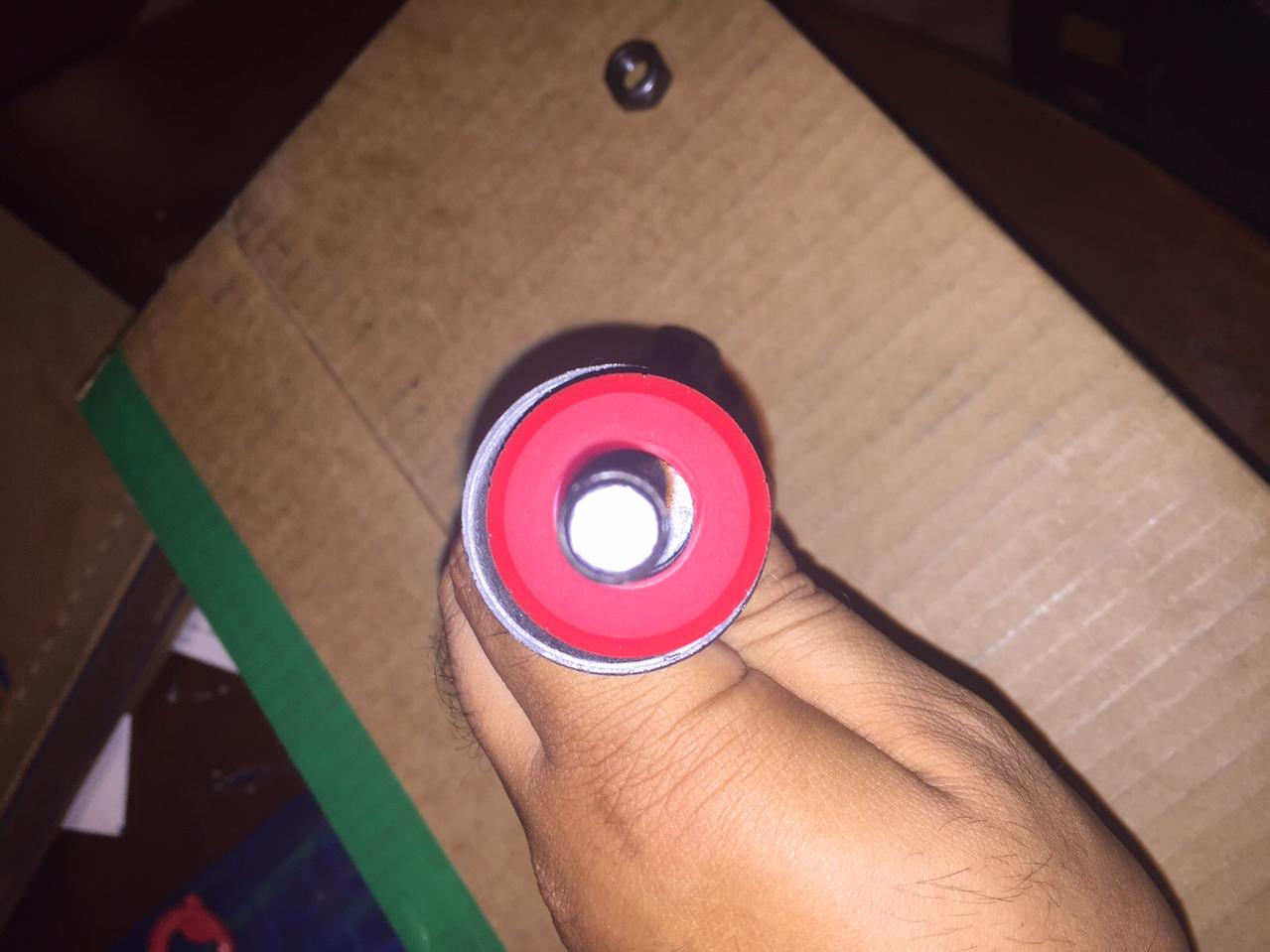

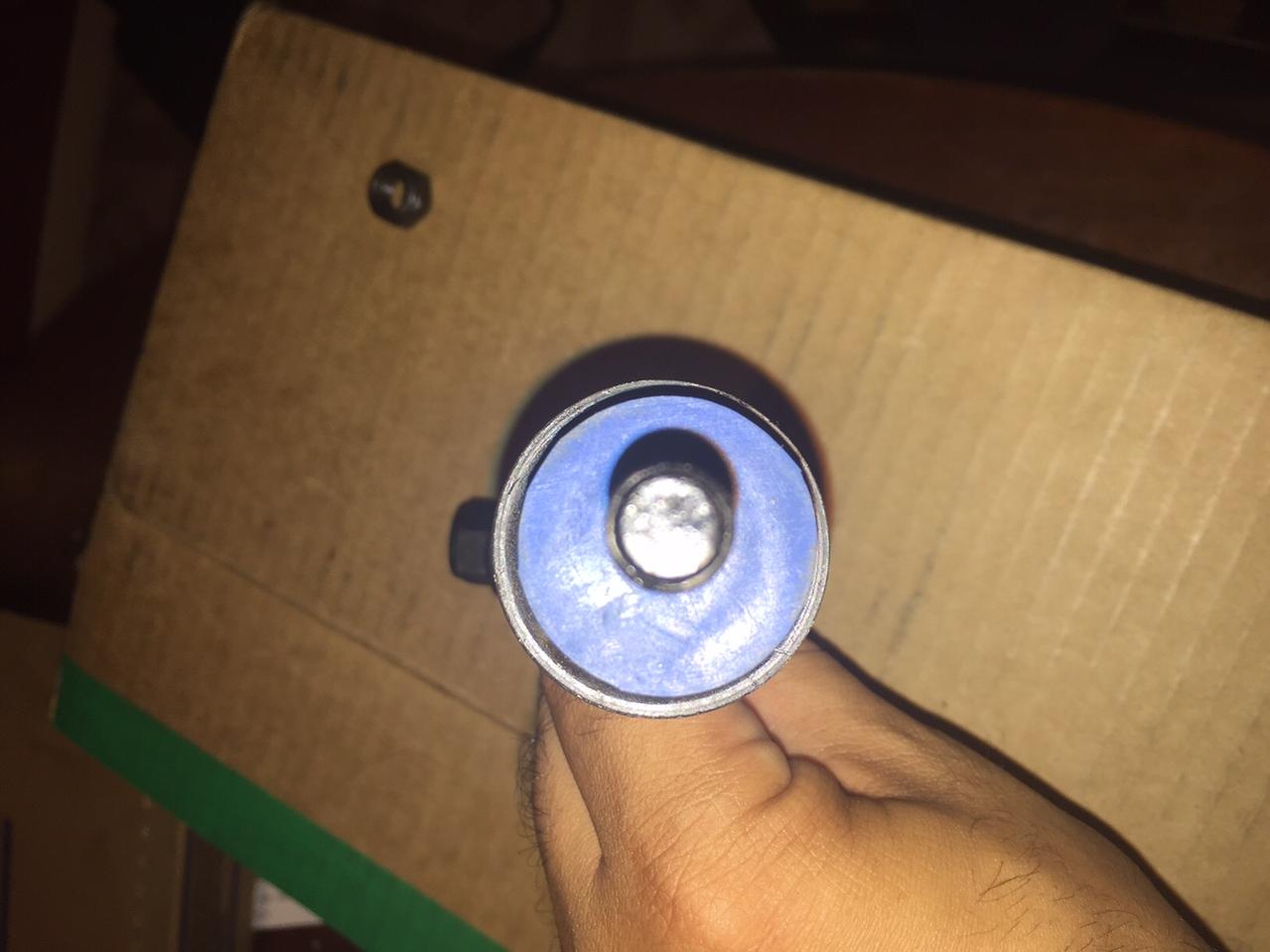

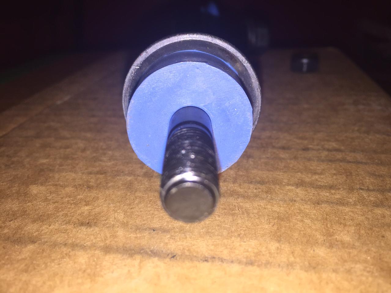

I just purchased new sway bar links and the links came with their own bushings, but I also bought new "performance" bushings. The "performance" bushings don't fit snug as the link bushings fit. Does this matter or its no big deal?:shocked:

If they're tightened down I don't see the problem. Maybe keep the ones they came with somewhere if a problem occurs.

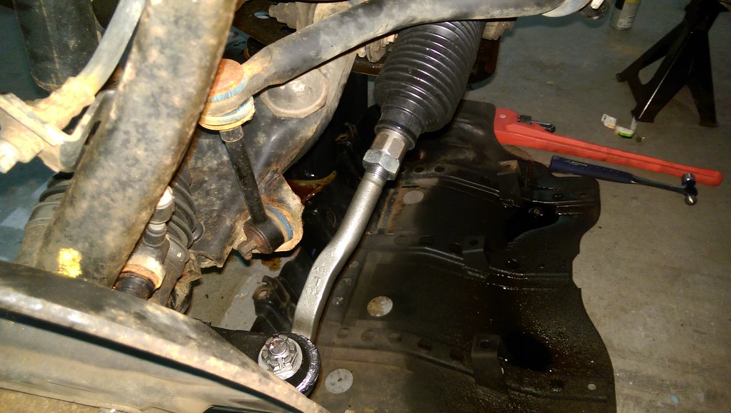

What brand are the blue ones? The ones I put on my truck look very similar, and they're junk. They've been on about a year and they're already cracked as bad as the 15 year old ones I took off.
Edit: Found a pic I took while doing the tie rods that shows what I'm talking about.
The blue bushings are Mevotech came with the sway bar links. The red bushings are Prothane. I was thinking once I tighten up the nut there would be enough pressure holding down the bushings in place.

Here is a relevant edit of your excellent pictures!
This is what Prothane told me. But, I still have a problem with such a sloppy fit. The inside diameter of the OEM bushings is 3/8". The red ones in the picture are 6/10". Almost a 1/4" difference. I've got the same problem with the Prothane 18-1115 kit and I'm not accepting this sloppy fit as "Good Enough". I plan on getting end link bushings from the Energy Suspension kit #8.5118 and get the correct fit.
