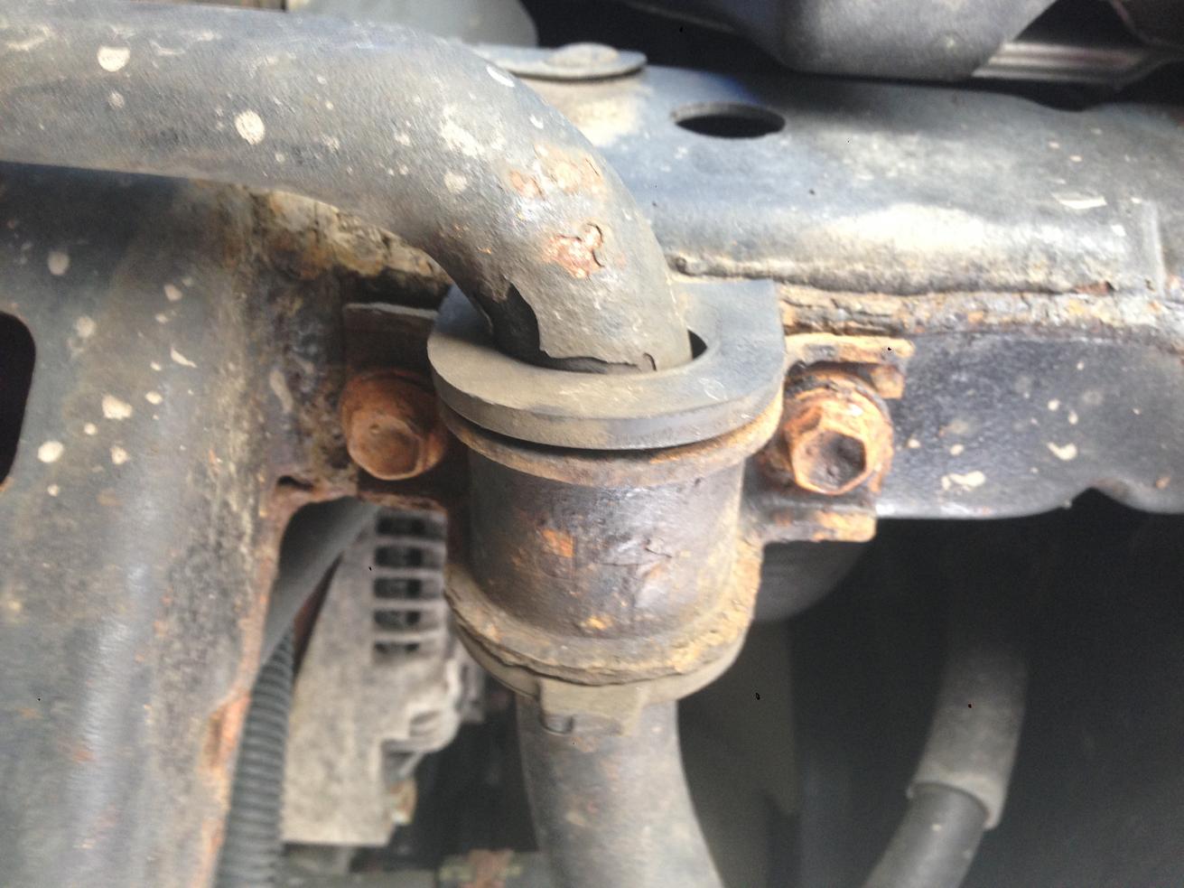

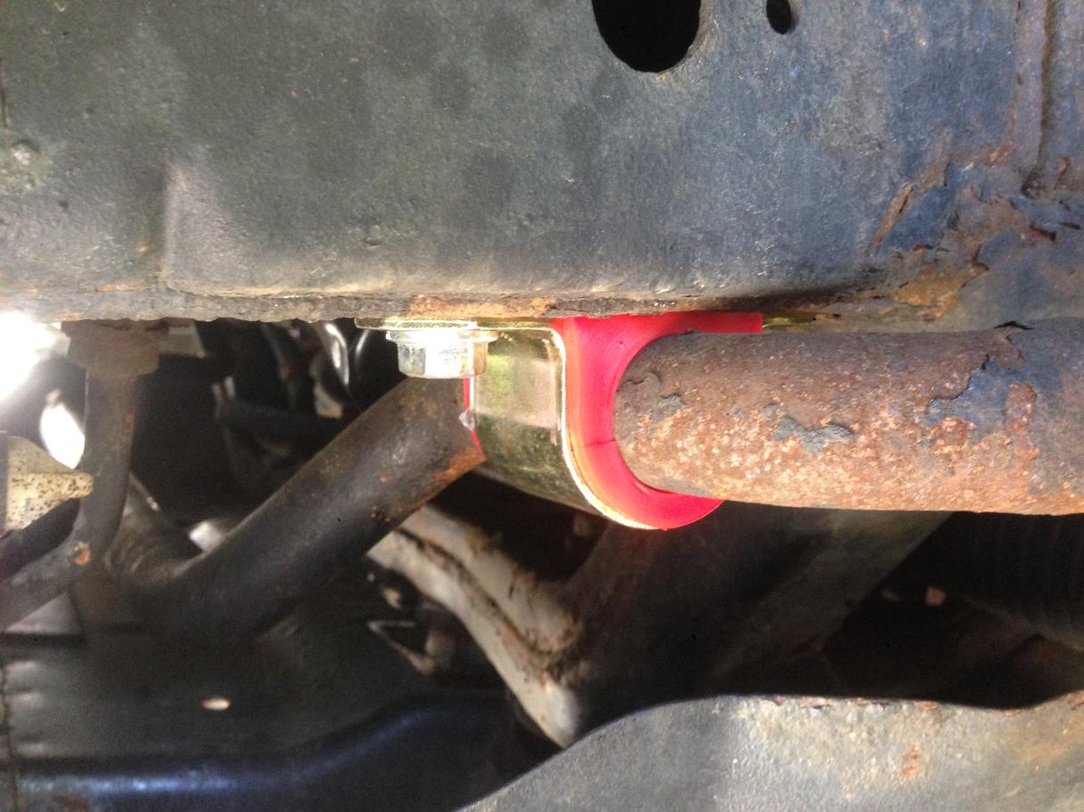

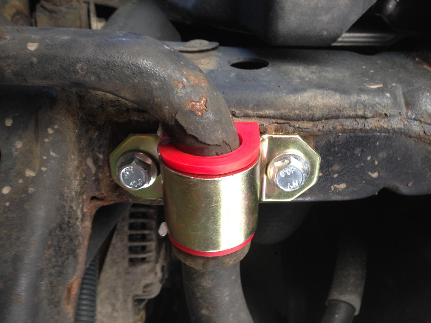

Ended up not needing any carriage bolts. All bolts came out relatively easily, exactly 38 minutes start to finish for the front only, including dropping/reinstalling skid plate.

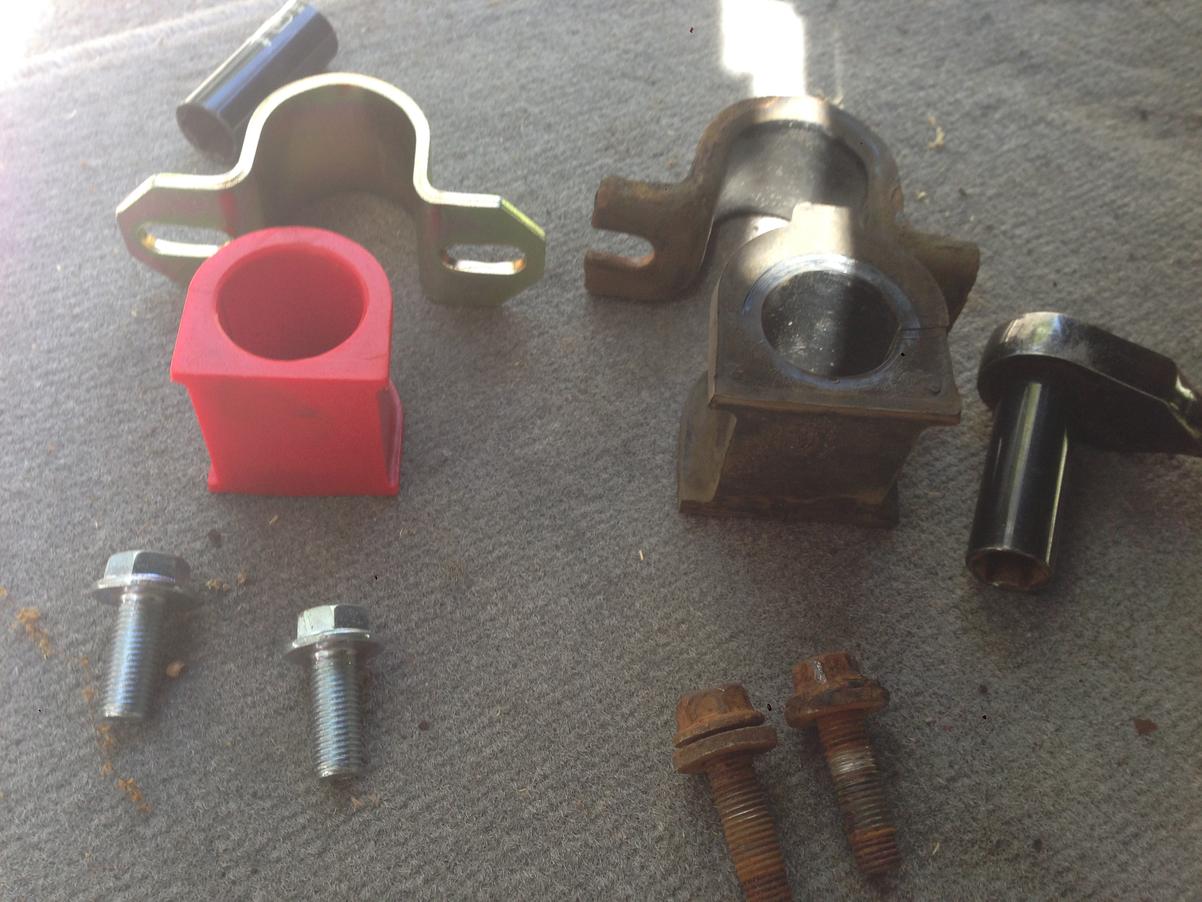

Added new hardware while I was under there
original
original vs new
new mounted
new mounted
