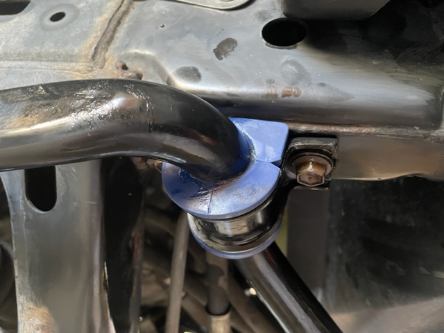

Just to add my data point - similar to Unner in a previous post, I went with the Moog bushings. My V6 Sport has 30mm front and 21mm rear stabilizer bars, so I used Moog #K80820 (front) and #K90396 (rear). The fronts come with the bushings only, while the rears come with a bracket.
I wasn't sure what type of grease to use on these, so I called Moog and they said to use silicone grease on the inside of the bushing (the bar side), so I bought some of the small ES silicone grease tubes from O'Reilly. Used about 1 1/2 tubes total between the front/rear.
I was real worried about the bolts breaking off in the front, so I hit them with PB blaster a few days beforehand and then right before removing. Squirting those front bolts is kind of a pain, because you have to squirt through the hole in the frame and aim the best you can at the bolts. You can kind of feel the front bolt but the rear one is out of reach, so I just did my best. Probably used a lot more PB blaster than I needed and now the vehicle and garage smell like hell, but that should eventually go away. 3 of the front 4 bolts came out just fine, but one was a little troublesome and was real tight when turning, but I took it slow and hit it a few more times with PB blaster during the process, and eventually it came out.
At first, I thought the front bushings might be a little small as they seemed to leave a small gap when placed around the bar, but after tightening up it looked like a good fit. I re-used the original hardware for the fronts and it all worked fine.

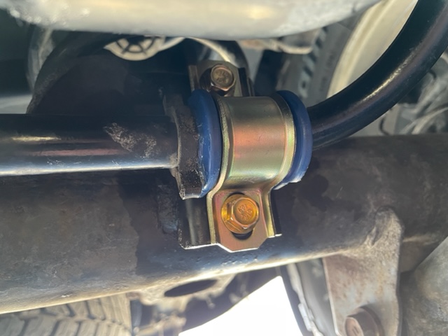

On the rears, similar to Unner I used the brackets that came with the kit, as the Moog bushings wouldn't fit correctly in the stock brackets. I also bought some new M8-1.25x20mm bolts with wider flanges because the Moog brackets indeed have a little wider opening and the stock bolts were a little skinny for my liking.

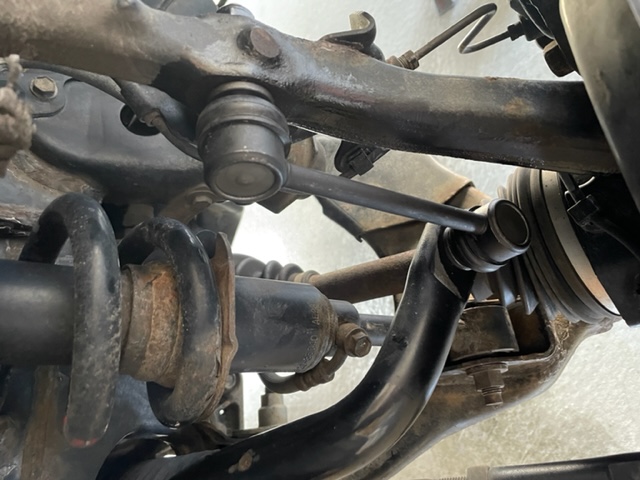

I also replaced the front sway bar end links while I was at it. I was going to go with the Moog ones, but after reading that many folks saw them corrode quickly, decided to try the Mevotech premium ones (#MK90683 left and #MK90677 right); they are supposed to be corrosion-resistant, but we shall see. I didn't replace the rear end links because I might be replacing the shocks/springs in the near future and may want to go with longer links.
