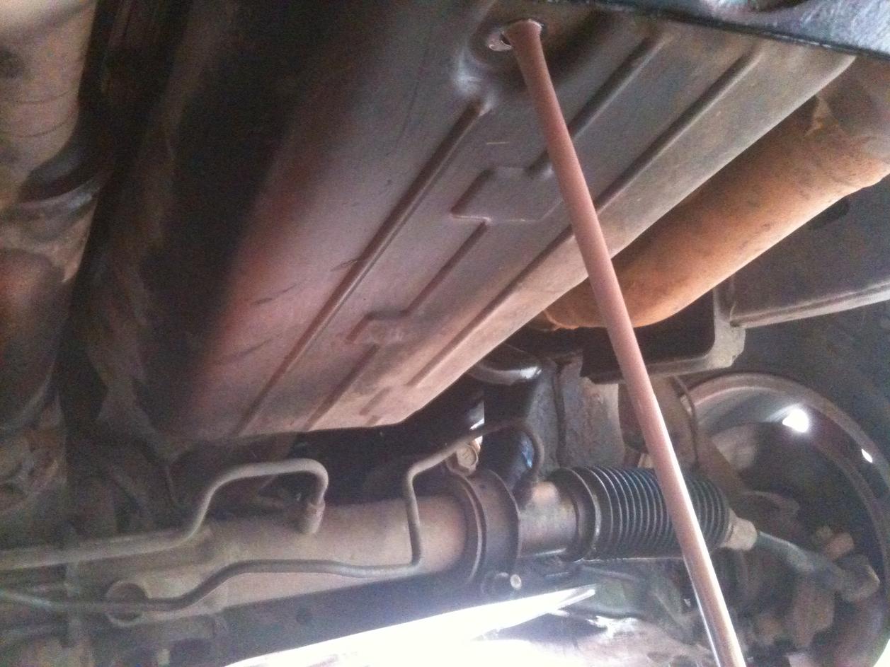

Was out doin some light wheeling today when my poor Runner just quit pulling. The trans was sweating out all the seals and I could hear the fluid boiling. A quick pull of the dip stick and it was covered from end to end with the pink milk shake. I persuaded it to back about 100yds out of the trail I just hit and she wanted no more. After sitting (turned off) on the windy power lines for about 20 minutes it was cooled enough to continue about another 1/2 mile before the clutches started slipping again. My Taco friend towed by busted girl to the house. Cooled off once again I tried to limp it down the driveway into the garage. There was no limping, it drove just fine with no slipping. Trans fluid is drained along with coolant. Gonna do a flush tomorrow and hope for the best. I don't think I smoked the clutches judging by it's performance and there being no clutch mud in the fluid.
What's the best external cooler to go with? (The one I should have already had!):redbrick:

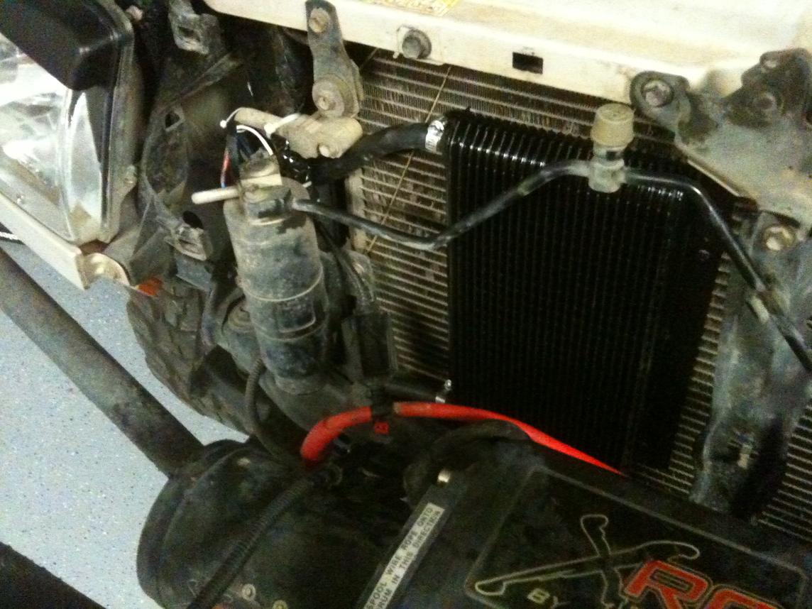

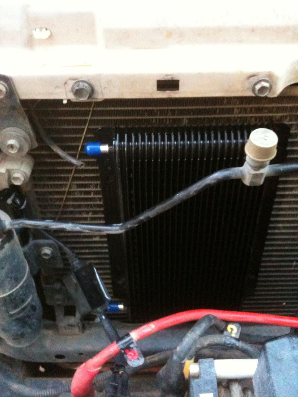

Thanks for the quick responses. I did me a lil research at the B&M site and the 70264 seems like the winner fo sho. Ordered:hungry:

B&M 70264 cooler is in and on my 3rd driving flush. First time I used 3gal of fluid to do a quick standing flush. Drain, fill with 3qts, start engine and allow it to pump the fluid out and into a 5gal bucket from the cooler line. Once it starts burping, kill the engine and dump another 3qts in, repeat. When I felt all of the water was out I refilled and drove a few miles. Trans acted like it was back to normal with no slipping and crisp shifts. But just to be safe I drained again, it had a slight pink to it. You know haw new fluid is clear, this was still nice and red but a little cloudy. Did that 2 more times and now I'm gonna ride with the cheap fluid for a while to make sure there are no leaks before I go back to Royal Purple and Lucas.
Long story short... If you happen to get the pink milkshake don't assume that all is lost and go for a rebuild. As long as you noticed the slipping soon enough and didn't try to dive it while slipping then odds are that the clutches will be fine and you can do a flush and be back on the road in no time.

On the SR5, I'm running in series because it's a new radiator. On the Limited, I did a bypass because it's the original rad.
