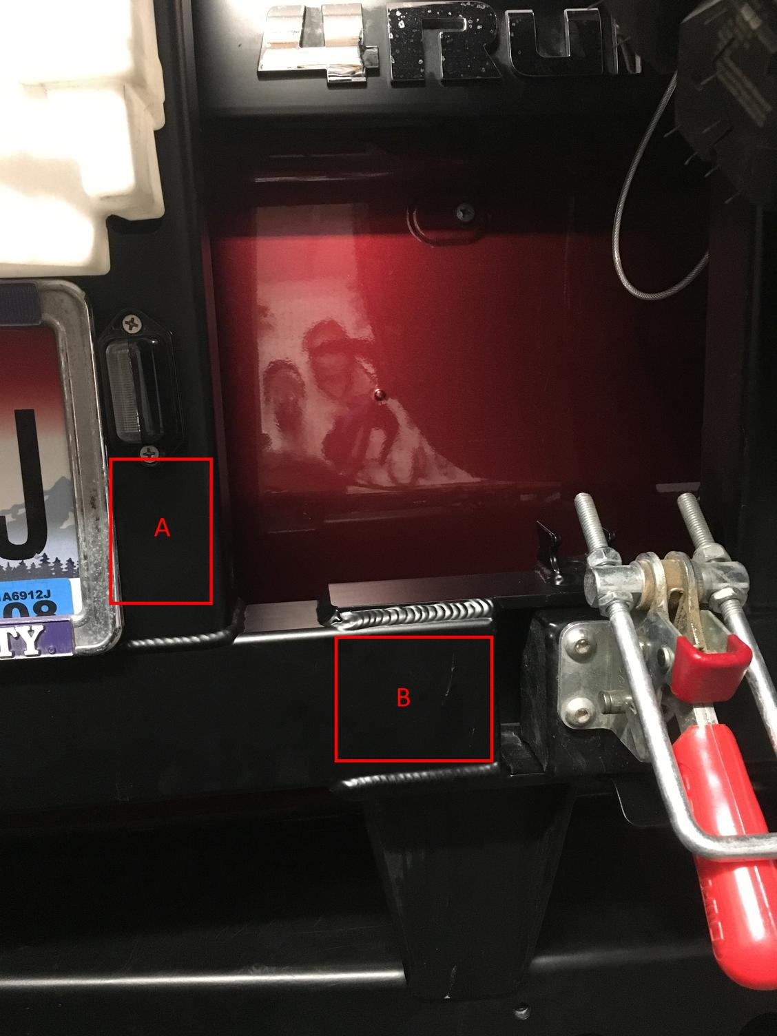

[MENTION=124732]LawnDart[/MENTION]- It looks like the camera is well protected under your second hitch. I have the same dual swing out but no second hitch, so that space on the passenger side swing doesn't look as appealing.
What are your thoughts on these 2 locations on the driver side swing? Would also shorten the cable run. (A) would be preferred getting some protection from the license plate light. Unsure if that light would skew camera visibility at night.
I want to be able to see behind for backing up of course but really want to be able to see my hitch for backing into a trailer.
I have the same setup as you. Thinking of going passenger side and putting camera in spare tire mount
Why not put it on the bottom of the rear spoiler? That way you can actually see how much space you have before your rear tire carrier makes contact with an object. That's what I'm planning on doing when my bumper comes in.
I wouldn’t mind checking out how you do that. I’ve been lazy and haven’t bothered moving my camera yet. I’ve got a Clarion lighted licenses plate frame and backup camera holder that I use on my cruiser with success, was just going to do the same here. Having it up high could be nice though.
Spoiler might be interesting to try. Unsure whether I could still get good enough visibility for backing into a trailer tongue. I'd be interested if someone has tested this?
Mounting inside the spare on the swing arm seems like I for sure wouldn't be able to see the ball/tongue final line up. My spare is angled up from CBI which makes that issue slightly worse than a flat mount.

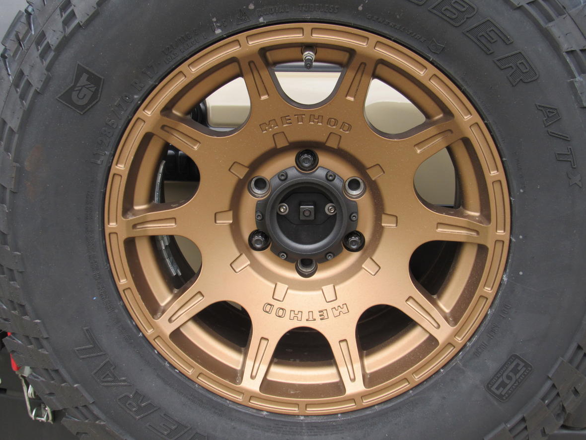

Relocation on mine was to the back hub of the tire carrier. It doesn't provide eyes on the hitch receiver, however throws a nice wide angle spread which is nice...

Adding some options here
Like my earlier post I mentioned I had ordered a used OEM back up camera from a wrecking yard $48. This made it much easier so I could leave the original camera, just unplug it, and luckily they had sent me the short wiring harness with the used camera so I could cut it in half and use it on my re-route lines. I routed my wires from the original camera location up the drivers side hatch window, through the rubber loom, along the top of the hatch opening to the passenger side, down the passenger side brake lamp and out the lower trim. Had to drill a hold, paint, and installed a rubber grommet to get the wiring outside the truck. Worked great.
This pic is upside down or however you want to interpret it. :)
