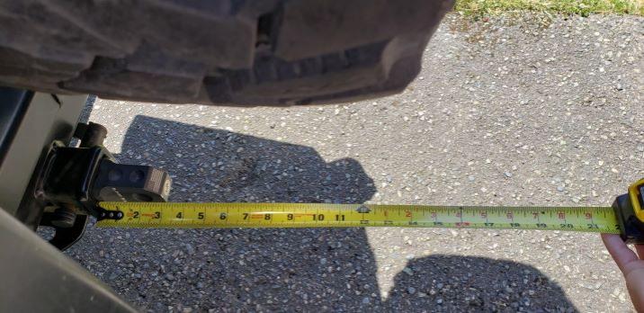

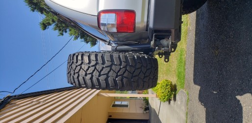

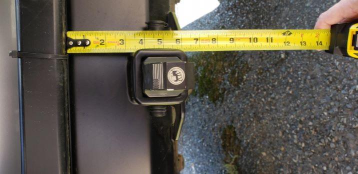

I am looking at their Super Duty single carrier. I have a 4x Innovations swing out loaded with a 315/75/16 spare. I am trying to figure out what sort of clearance I am working with.
There is about 3" between the bottom of the spare and the top of the receiver hitch. The spare comes out about 14" from the receiver hitch.
I imagine that I will probably need an extension. In addition to an extension, they also *can* reverse the side plates that angle the rack up so that they angle down. I am wondering if I will need to do both, or if I can get away with a 1Up standard super duty single bike rack.

Hey itskohler, thanks for chiming in. A measurement or two would be awesome! I found plenty of 5th genners using the 1Up, but very few people are running any type of swing out situation. A few are using a CBI swing, but they seem to offer some receiver built into one of the swing arms.
So I think the magic point of reference that I might be looking for is, what part, if any, is the the rack in conflict with at 3 inches higher and 14 inches post receiver?
My guess is that it very well might be the side plates that the platform pivots on, or the bike platform itself.
I think I will definitely need a hitch extension that should provide 7" or so of extension. I am just trying to figure out if I will need to custom order the reverse side plate configuration.

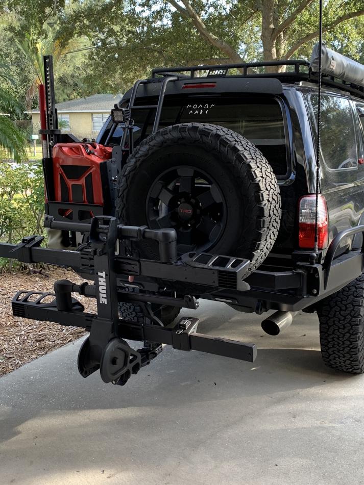

I have a different setup but maybe it will give you ideas...I used a a drop for clearance...my swing arm clears the wheel
Holder by an inch or less.

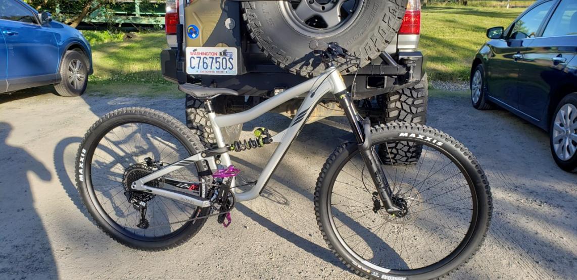

I just did a quick mock-up so disregard it isn’t really attached. I grabbed by race bike because it is the lightest. I calculated that I would need a 10” drop to clear the lowest part of the swing arm/tire by measuring from the bottom of the tire. While the tire is lower than the arm (just a bit) the arc of the swing arm and the position of the tire (more proximal to the hinge make the tire irrelevant...meaning the arm will always be closer to the bike racks highest point than the tire if that makes sense. I didn't know that when I was guessing what I would need. I could possibly just make a 8" drop work but I wasn't interested in taking this back and trying. For you with a 315 as opposed to my 285 it might matter more…hard to predict...your rack is different too. The 10” drop I went with is way overkill as it is for 10K lbs. For the life of me I have no idea why I bought it vs something else. It isn’t cheap… Amazon.com: Roadmaster (048-10) Hi-Low Hitch: Automotive
After mounting this way everything cleared (by a little over 2”)
The 10” drop wasn’t snug and the whole setup wobbled a bit…that was fixed by adding a hitch tightener which you can see sitting on top of the drop (not attached in the pic).
That solved the problem…everything is snug as a bug now. The tightener I purchased is here:
Amazon.com: StowAway Hitch Tightener, Anti-Rattle Stabilizer for 2 Inch and 1.25 Inch Hitches: Automotive
When it is folded up the bike rack is maybe and 1" or so from the tire on the swing arm....really it just fits.
Hope this helps.

I have been looking at those, but it is hard to see where the contact would be, (if it would), between the bottom of the spare tire and the top of the down plates. I think I will get a longer extension to clear the space the 14" spare will need so that the first bike tray isn't touching the rubber.
I don't even want to be able to swing the tire carrier. That's just not going to happen. LOL. It will work, but just drying to figure out if I will need to order the reversed side plates.

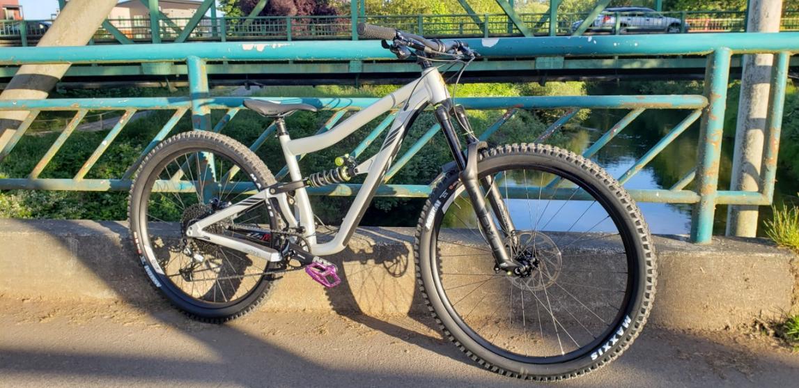

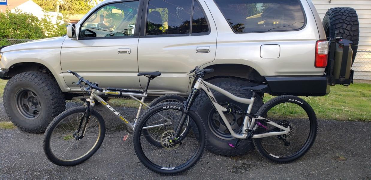

It's a Ripmo AF. Carbon is a bit rich for my "getting back into it" blood. Hahaha. It has been a lot of fun. Let's put it this way. My last new bike was 1995, a GT Avalanche. So I am getting used to FS, disc brakes, new geo, 29" wheels.. where does it stop? lol. Just getting my legs and lungs back.
