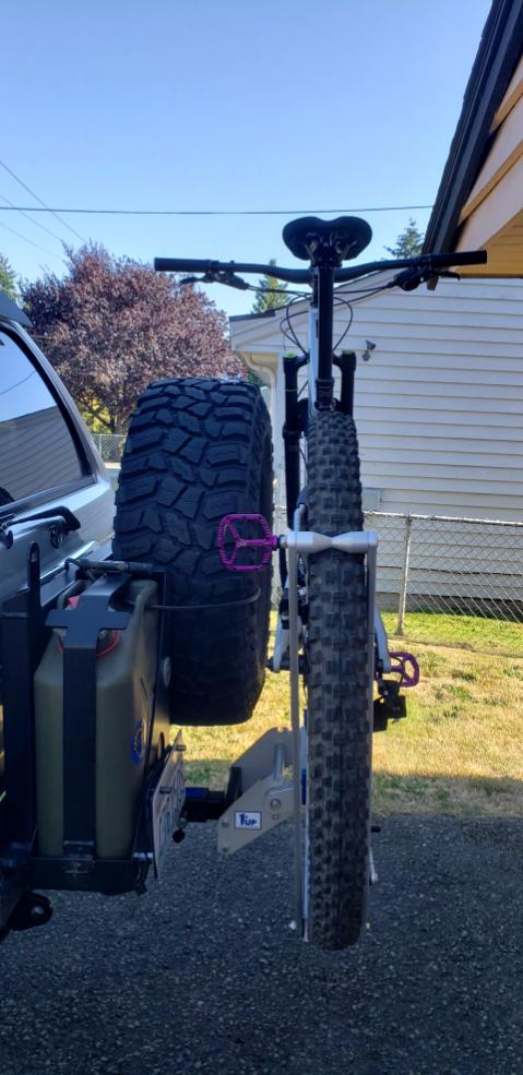

I ended up going with the 1Up Super Duty 2" single carrier with single additional add on carrier. I will post pictures with a bit more detail concerning fitment with a 4X Innovations swing out when I can.
The short of it is that I didn't have to order the custom "side plates down" version of the rack. I added a necessary hitch extender and it fits just fine. The bike sits up high, (as is the design), and out of the way. The extender is variable, but in my configuration, it is about a 7" extender.
Here's a couple of quick crappy pics.

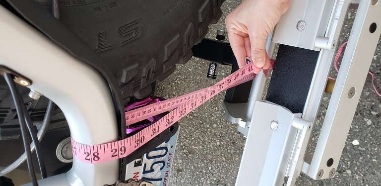

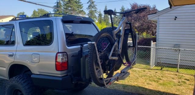

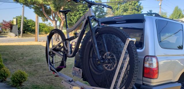

Answer to fitment.
Situation:
Vehicle: 2002 Toyota 4Runner (lifted ~3", modded, armor).
Hitch: 2" 4X Innovations swing-out bumper with tire carrier loaded with a 315/75/16" (35") spare.
Bike rack: 1UP 2" Super Duty Single +1 Add On.
Problem: What will it take for the bike to mount and clear the spare tire?
also: Do I need to order the bike carrier with "Reversed Side Plates" (this lowers the orientation of the rack downward rather than standard / upward).
TLDR: With about an 8" hitch extension, the standard configuration will clear my mounted bike by about 2".
Oh! You have time to kill? Say no more!
Further revelations: I wanted the standard configuration as long as it would work for my current vehicle. I wanted to avoid having to give up clearance on my current set up by having to order the reversed sided plates. This loss of clearance would be a greater annoyance with a non-lifted vehicle.

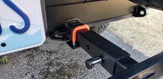

Security? I can't say that I have a warm fuzzy feeling about security. First the 1UP rack security with my situation is not ideal. For one, it looks like it might just be on older, perhaps, the 1UP 1.25" version, but there is no hole for running a lock "in front" of the security anti-wobble allen key. Maybe it's a trade off between the two designs between the 1.25" and the 2" versions.
The 2" version has a long skinny channel to pass a hitch pin lock through. BUT the best you can do is use the teensy-weensy 1UP or like thin shaft lock. A standard hitch pin lock will not fit. Booooo. LOL. I think they could have opened up the channel a bit to allow for a standard / larger hitch pin lock to be used, but... they didn't. I am using their hitch pin lock and even when it is all the way tight, it still has some room between it, and the hitch.
