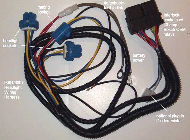

I am going to add Lightforce 170s to my 4Runner. I will use either the Painless or SuvLights wiring kit. I will probably connect the low amperage lead to the existing fog lamp hot wire. That way both sets of aux lights will operate at the same time. Maybe later I will extend the low amp wire into the 4Runner to a dash switch. First things first, I am going to a metal fabricator to create a light bar that connects thru the lower grill into a secure member of the bumper. Something small and specific to the Lightforce lights, as I do not care for huge bull bars. I can

I do have the stock fogs, but what I'm interested in doing is adding a set of PIAA driving lights on a Westin bar. I like RL's idea about wiring the lights to the Fogs but I think I'm going to make them selectable if possible.
RL...is it possible to just tap in to your existing wiring? Won't that overload/melt the stock components?
I think he meant to tap into the exising wiring to trigger the relay that controls the lights but power for the lights would (should) always come directly from the battery or power take-off.
The easy to wire aux lights is to use the stock fog lights to trigger the low amperage side of the relay. The high amperage power for the aux lights comes directly from the battery. Easy & safe.
At this point, I would like to have the stock fogs continue to light right in front of the 4Runner. The Lightforce lights will light the road beyond the area the fog lights cover.
