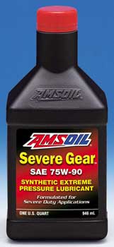

Best stuff in town....had very good success with it. Go to www.amsoil.com and plug in year, make and model. It not only tells you what fluids to use for everything, it tells you all the capacities for your truck too. VERY easy and much more affordable than the retail shops IMHO
