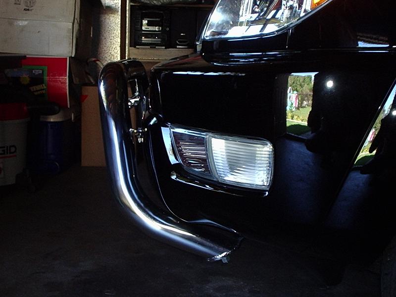

Ok i started this thread to show the mounting points of the T&H Bullbar since there are more than a few that are interested.

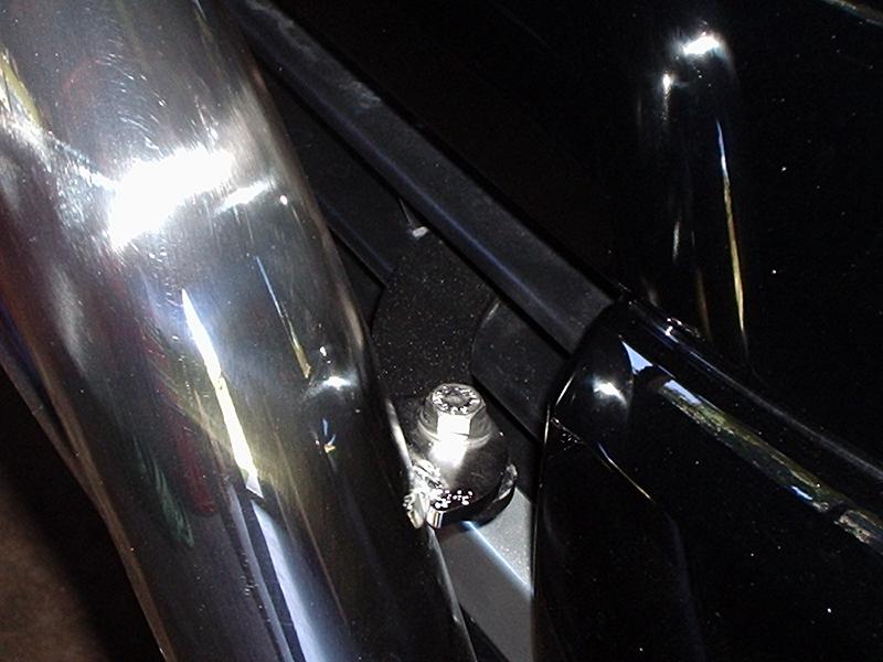

This is the top mounting point of the bullbar. the bracket goes through the back of the lower grill and out through the front where it meets the mounting tab on the bar. this is on the driver's side.

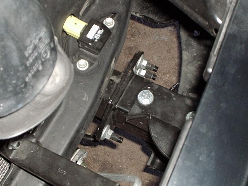

this is the inside of the hood where the top bracket mounts to the frame behind the bumper. (hood open) there will be a rubber flap you will need to remove in order to reveal this mounting point. i chose not to put the flap back on when i was finished.

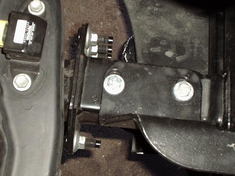

the rubber flap attaches at two places. the bottom of it actually attaches to this mounting point. this is a closer shot of the bracket mounted to the frame.

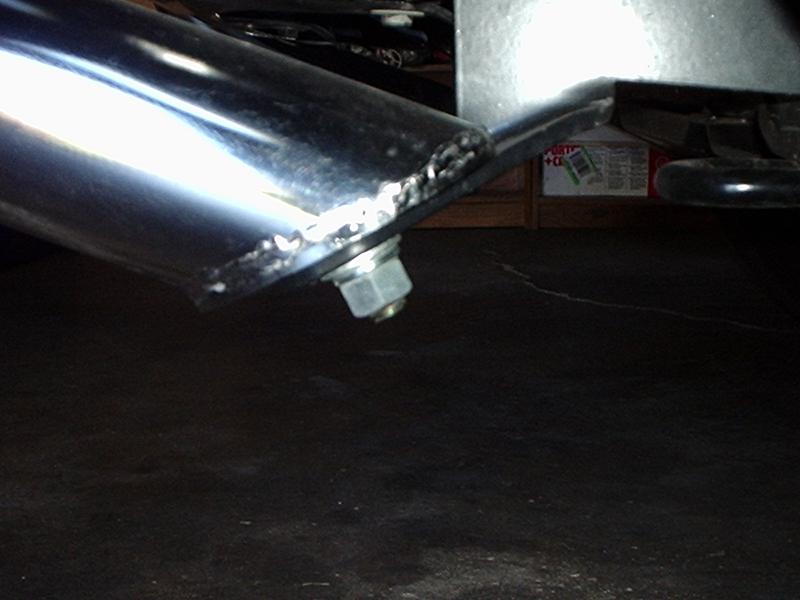

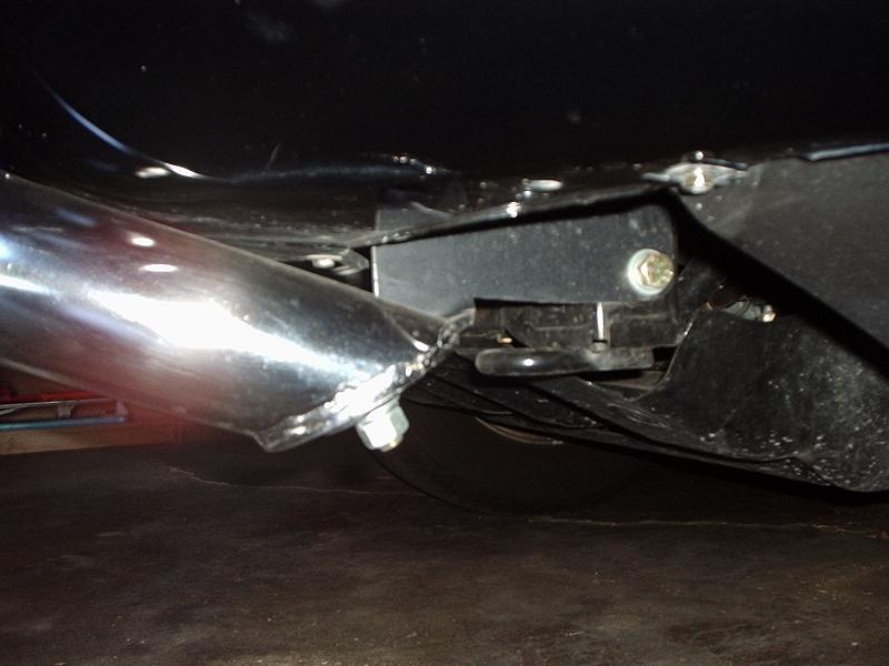

remember......all of these shots are on the driver's side. this next picture shows the lower bracket attached to the bullbar.

good luck to all of you who plan on installing this guard yourselves. remember to be careful not to sratch you bumper when trying to fit the guard and it's brackets. it takes TWO people. the clearance on the bottom of the bumper is what you have to especially watch for. if you want to be safe......tape up the two sides of the bottom with painter's tape, AND the sides of the lower grill because the top brackets might rub against the sides whil you are trying to put them on. good luck!

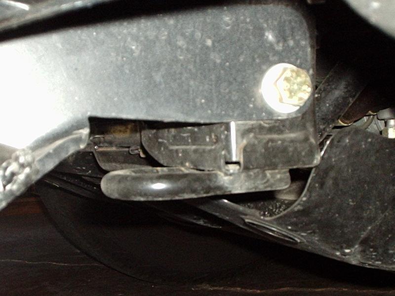

P.S. Noloc, as you can see......the tow hooks are not in the way at all.
