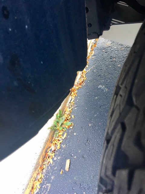

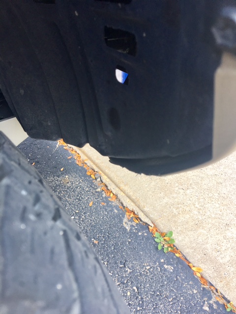

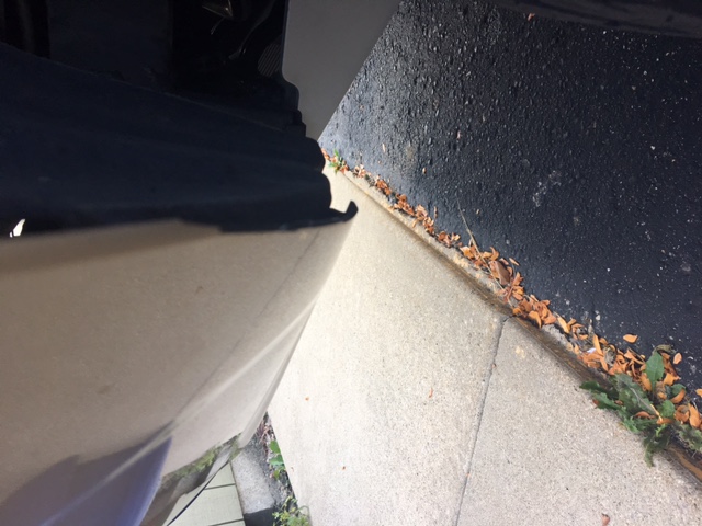

Just discovered this post. My '16 Quicksand Pro has jagged but uniform cuts on both sides of the front bumper. I always thought it was kind of unfinished looking. Does anyone else have this on a '16 or newer Pro?
The ones I've seen in Colo Springs have the fender well pulled all the way forward, so it's in front of the plastic bumper parts and it's trimmed with what looks like a razor knife.
Here are some pics. Actually, the passenger side is more jagged than the driver side. Pics are of the front bumper cover (quicksand) and the fender liner.
That looks like ass and the shitty job Liberty Toyota does on their "Stage 2" Toytec lifted Off Roads (technically these aren't Pros, but the interference issue is the same with the lift and bigger tires).
I think one in the showroom had a more professional job where it wasn't jagged while the other looked like it was done with safety scissors.
