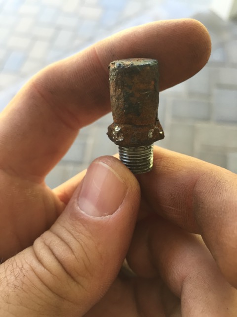

Changed my diff/T-case fluids with Mobil1 75w90 full synthetic.

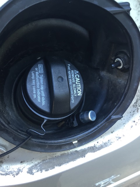

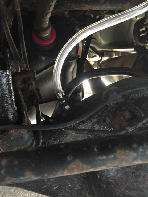

Did the rear diff extended breather modification.
Original was shot, not sure I trust this one anymore.
I wasn't sure about the clear tubing at first but with more than 1,000 miles so far it seems to be just fine. My concern was the hot diff fluid melting the tubing, but my reasoning is that the replacement breather is made to go directly into the axle, and if the breather is made of plastic, then the tubing would be just fine. Ran the tubing from the diff...
To the gas cap as most other people have done. 30 minutes max

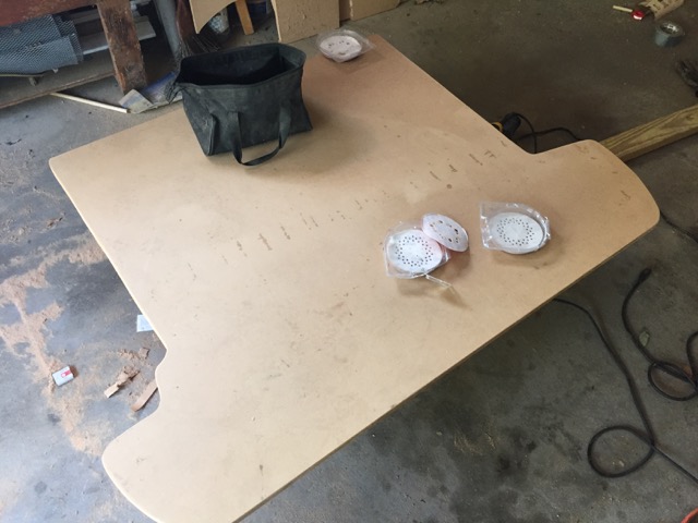

Started work for some sort of drawer system. Thinking of only doing a drawer on the "40" side of the 40/60 rear seat, and a sub enclosure above the driver side wheel well. Also contemplating on board air, putting a tank over the opposite wheel well.
This project is definitely back burner, I want to be 100% sure on the set up before going forward with the construction.

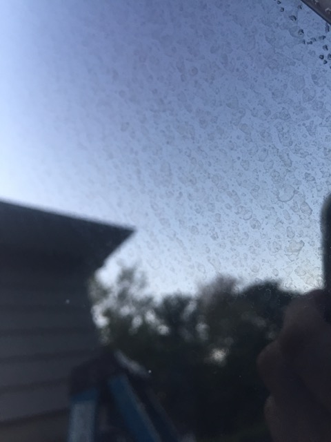

Cleaned the water spots off my windows with http://www.amazon.com/gp/product/B004BFW0EO?psc=1&redirect=true&ref_=oh_aui_detailpage_o07_s00 and an orbital buffer. about 30 minutes PER window, but well worth the time.
BEFORE
AFTER

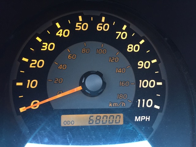

And hit the ripe young age of 68,000 miles
