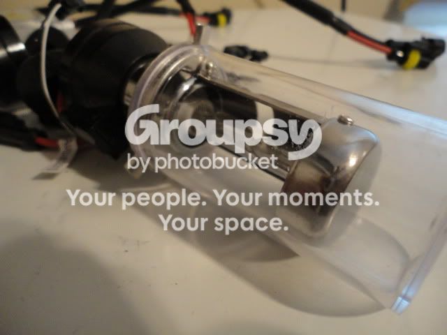

I'm not sure how your bulbs look but did the look anything like this...? (minus the pastic covers)
010.jpg~original
if not the metal thing in this pic is a shield that comes with the DDM kit. From what i have heard on here it blocks the light from the bulb from shining on the lower part of the reflection housing which causes a lot of the glare. You may be able to fab something up like that?

yeah they look the same as the but the reflector is under the light and not over i thought the shield would be ontop of the HID when i put it in but it turns out it doesnt and it only fits one way.
yeah that threw me off too haha but i guess cause its more flat on the bottom causing the light to bounce up. Dang im stumped though, do you have a 35watt or 55 watt kit?
