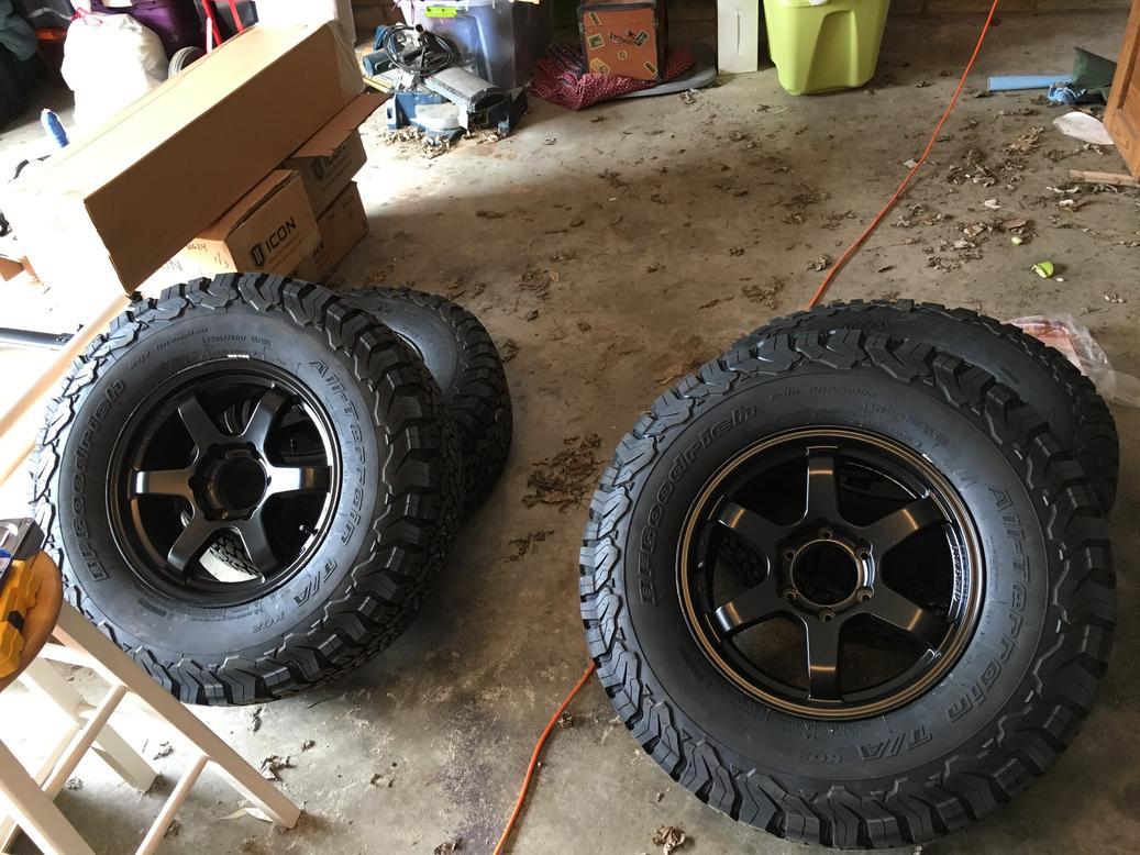

Kira finally made some progress! I received my wheels from FN Wheels and my Gobi rack from Trail Duty within two days of each other. Go time!

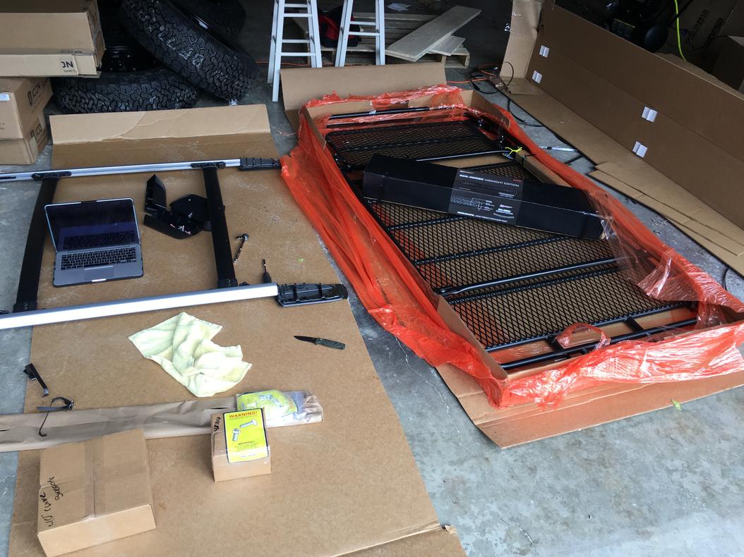

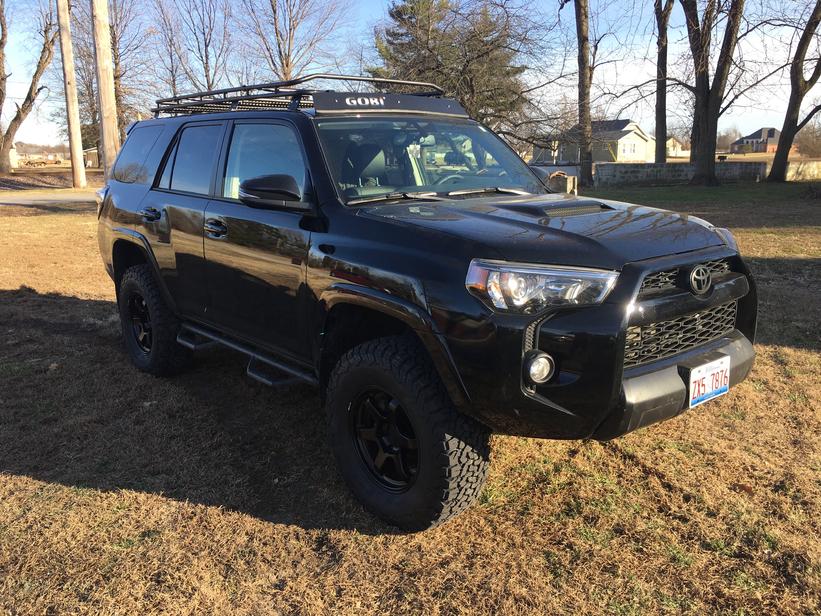

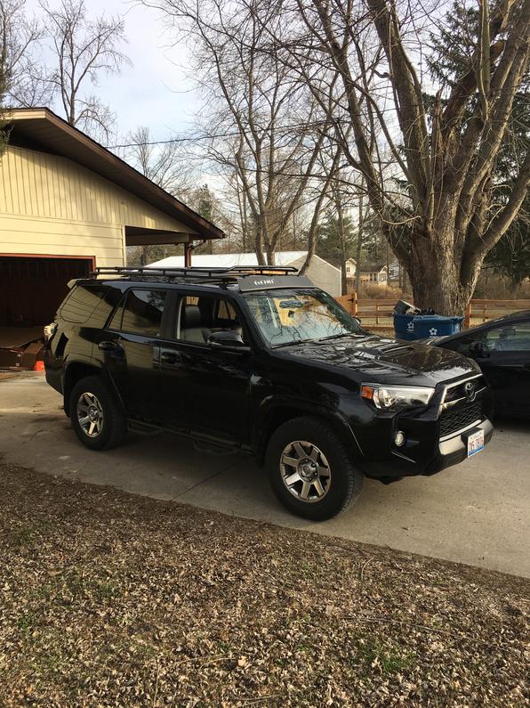

I decided to go ahead and install the rack myself because, well, I was bored. A few hours of wrenching in the driveway and it was done. I will say that while removing the factory roof rack be VERY careful. The instructions I found said to lay a rag between your pry tool (flathead screwdriver) and the body of the truck to protect it. This is NOT enough. I put small dents in my roof line at all of the bolt/cover locations. I'm super annoyed by this and sadly they're so small I didn't notice right away to prevent denting the others after I did the first one. I'd say use a magazine or piece of cardboard instead. Anyways, aside from that and my hands hurting from wrenching in the 35 degree weather, the install was pretty easy to do. The only time I needed help was carrying the new rack over the top of the vehicle to rest it on the mounts.
Another thing worth noting is that when I ordered the rack from Trail Duty I simply ordered the Rigid 40" curved RDS LED bar. what I received instead was the "Midnight Edition" of the aforementioned LED bar. I'm SUPER excited about that fact. It's not what I asked for, it's better IMO. That being said, electricity scares me so I have NO intention of installing it myself.

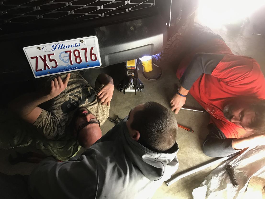

I decided that despite my lack of experience with installing suspension, I valued the idea of familiarizing myself with my truck enough to take a crack at it myself. I then loaded Kira up with the ICON suspension, new wheels and tires, and a plethora of tools and made the 100 mile drive back to my hometown to my big brother's house in order to install the suspension with him and our dad.
We followed the instructions found on this forum for installing lifts on KDSS equipped runners posted in 2013 by [MENTION=85512]eddiebx[/MENTION]. His thread combined with the other one he links to were both really helpful. One major thing that stumped me was a step where he disconnected a steering stabilizer. I had a lot of trouble finding it on my truck since it doesn't exist on mine! :doh: Another issue we had was that his thread makes no mention of replacing upper control arms, so we had to wing it with the provided instructions from ICON which were barely a grade above useless IMO. We got it done...in about 8 hours...:censored:

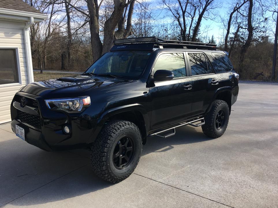

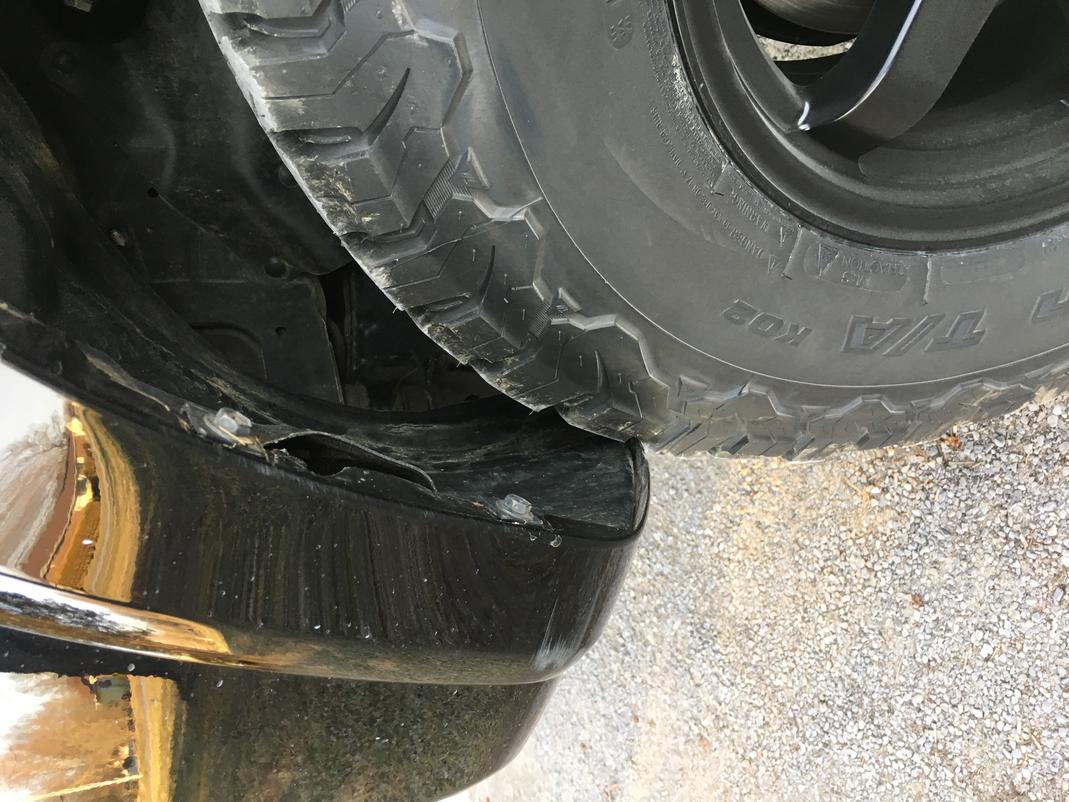

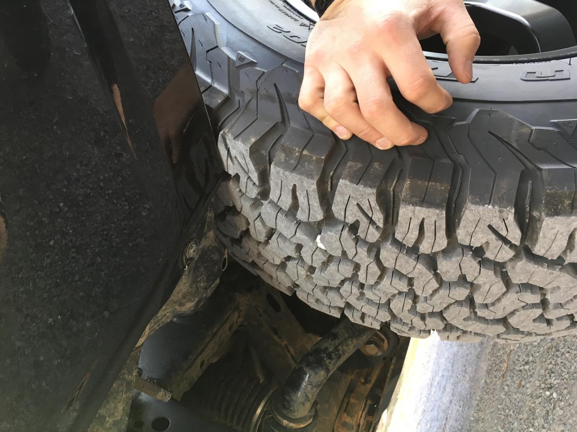

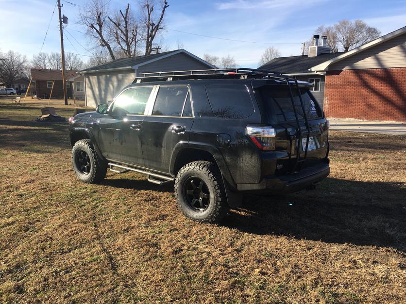

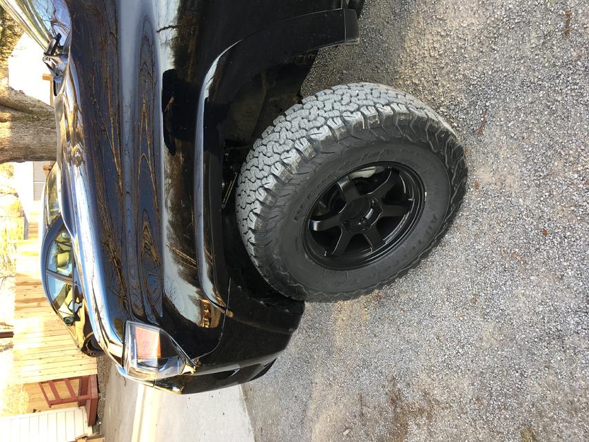

Here is a photo of Kira now that she's all done. I'm dealing with some tire rub issues. Removal of the mud flaps made the proper clearance for when I'm going forward. However, I'm rubbing on the actual bumper when going in reverse. By that I mean the actual gloss black finished portion of the bumper, not just the fender liner. The only solution that's obvious to me is to cut a portion of the lower inside portion of the bumper away with a Dremel tool? I took some photos to gather opinions from you guys before I perform impromptu surgery on her. Also, will my clearance be good when the suspension is flexing or will I require more modifications to the fender area before being able to play off road with her? For some reason despite trying several times I can't seem to get these photos to not being turned sideways. I hope y'all don't mind. Thanks in advance for any wisdom.
