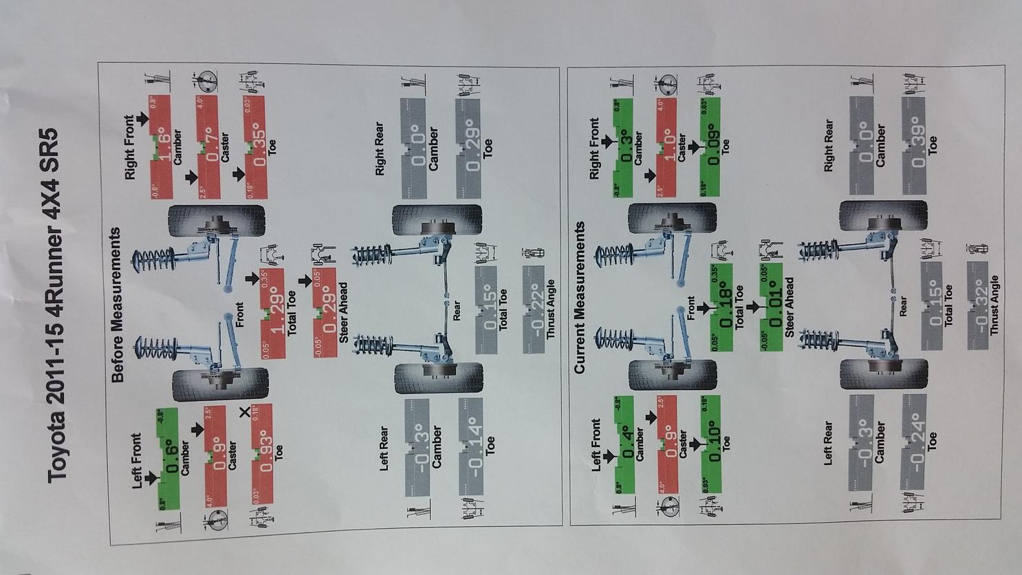

Initially, Fronts went from 34 to 38.0" rear went from 36.75" to 38.5"... I'm sure it will settle at least .25" lower all around after a few weeks.

Before and after...
Included a free scratch on my steering wheel, compliments of the service tech.

You need to get your alignment redone. Those aren't good numbers unless you have the coilovers maxed out. Might be time for UCAs otherwise.
If everything is within the mfr tolerances why wouldn't these be good numbers? You're never going to have a perfect alignment. I'd be interested to hear what you think are good numbers and what expertise you have with alignments.
Your caster is not in spec so you are OUTSIDE of the mfr tolerances. Don't need to be an expert to see red vs green.
Most people with around a 2 inch lift have no problems being within spec on all aspects and some on the higher end of caster, which will make the truck be more stable and less apt to wander on the road.
I am within spec but on the lower end of caster and it wanders alot on the highway. When I get my LT done I will shoot for around 4 degrees of caster.
Thanks Captain obvious... I'm not worried about caster... all I care about is camber and toe for tire wear... and this suspension created over 4" of lift... .9 is t too bad and i dont wander on the highway...
