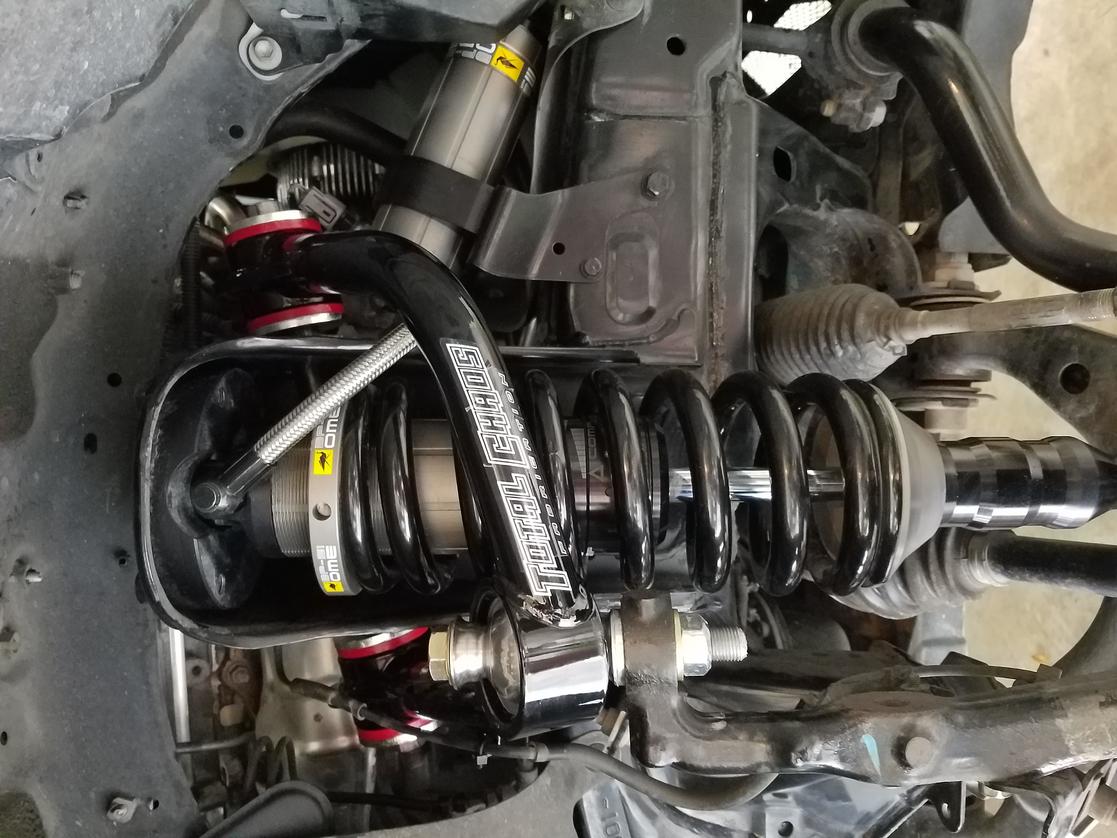

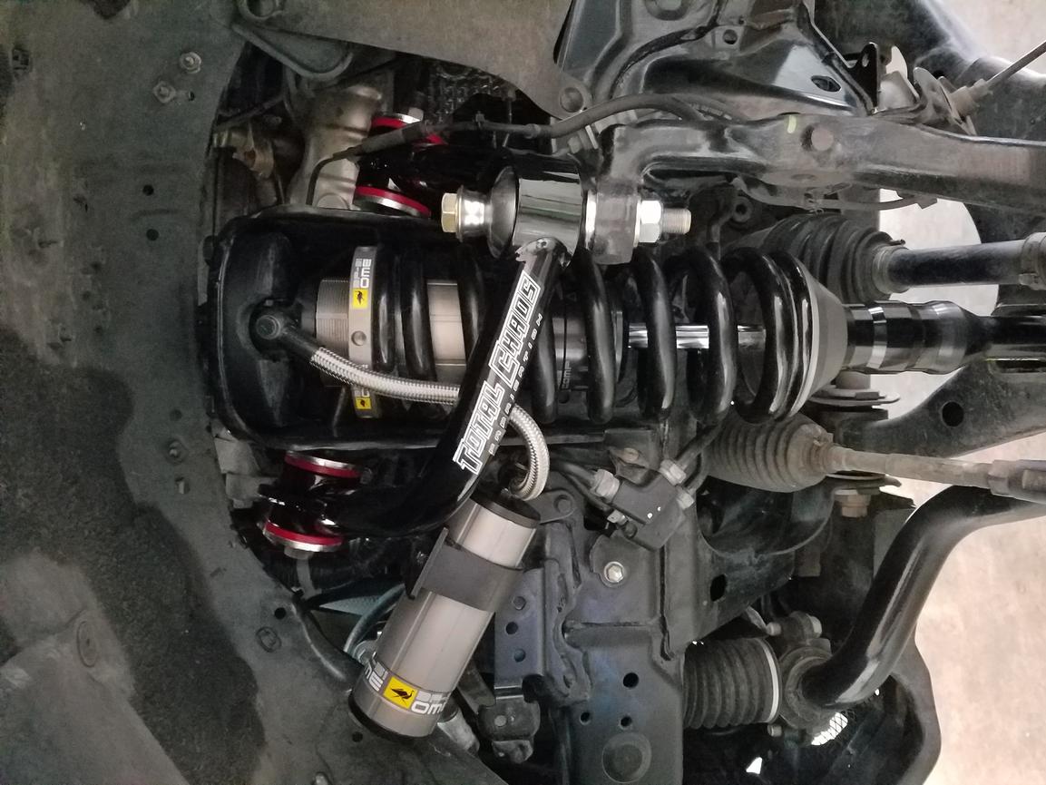

And they are in! Pretty easy install. I love the gloss black podwercoat... I'm going to attempt to hunt down some black bushings in the future. Tried to give TC some love, but I don't think these stickers will hold up long... and I found my passenger side cv shaft has a little play/clunk in it... the saga

I am sure your alignment will come in much better now. Please provide your objective impression on stability on the highway; I would have them shoot for 4 degrees of caster.
I would also like to mention that one of the "sales points" of the BP's is "retain stock UCA's". I call BS on this. But, I do think that the BP's are one sweet set-up! Looking forward to the full report on this nice rig!

How do you like the quality of the TC UCA's?! They look sick in black btw!!!

Steering on the highway is a night and day improvement, very tight steering now. I'll try to get it realigned next weekend.
