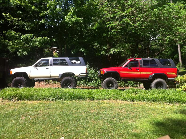

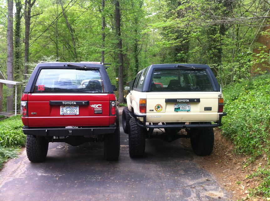

Here's a couple pics next to my 4th gen

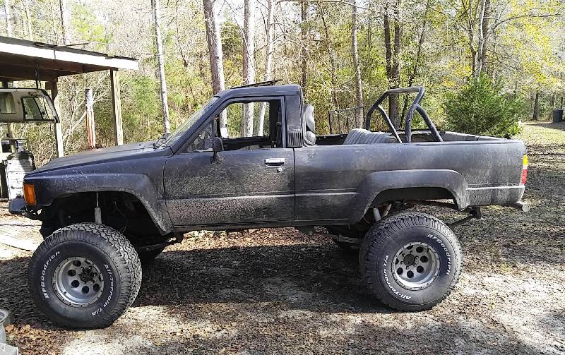

The SAS adds a bunch of lift naturally because of the way the frame is, 3 inch lift springs will make it really tall.
Mine has 4.5 inch shackles with a modified RUF pak and it was about even with the rear using the 3 inch lift blocks. It would clear the 38's with that setup.

I have just about all the same things done to mine, and I personally don't like how tall it sits in the front with the 3" TG springs. If I were to do it again i'd find a set of 3rd gen RUF. They'd still leave you with plenty of clearance for the 35's and you won't be a mile in the air.

Tinman, as an 85 wasn't yours a straight axle from the factory?
I think the frame changed from 85-to-86 so that a SAS causes even more clearance/lift than on the earlier models.
I know it did on the trucks, not positive on the 4runners. But it stands to reason.

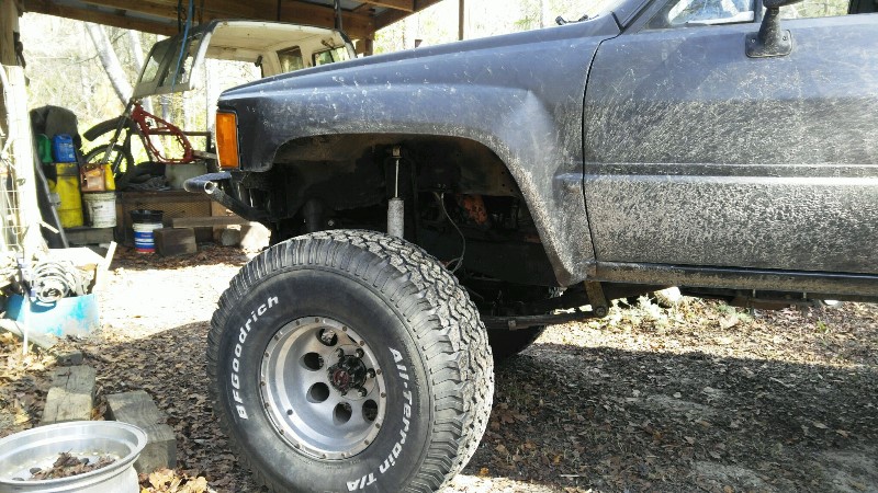

At the risk of hijacking the thread with pics om my runner, here are a couple showing the clearance with fairly flat RUF's and 35 AT's.
Got to love January in Florida! :)
Yes the IFS frames are flatter, and therefore add more lift if you put leafs under it. I was just trying to imply that I'd never use the trail gear leafs again, and do RUF/63's because they not only work better but its significantly cheaper. But then again he got the trail gear ones for no cost, so he might as well use them.
Here's my 85 next to my brothers old 86. With his sagging springs and my brand new springs we were the same height both on 35's.
