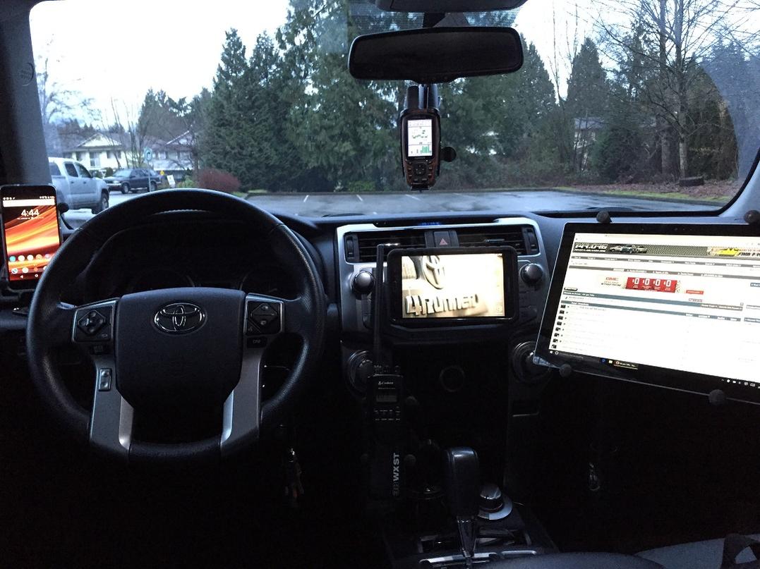

I'll take a picture of the current setup and post tomorrow

Installing a head unit in the 4runner is actually quite simple with the correct adapter cables. If you're handy with hand tools, you can have it completed within an hour. Most everything on the dash just snaps together like an old Snap-Tite model from the 80's, and the deck just slides out after you remove 4 10mm bolts. Unplug deck, plug adapters into wiring in vehicle, plug new deck in, screw it down and snap it all back together.
