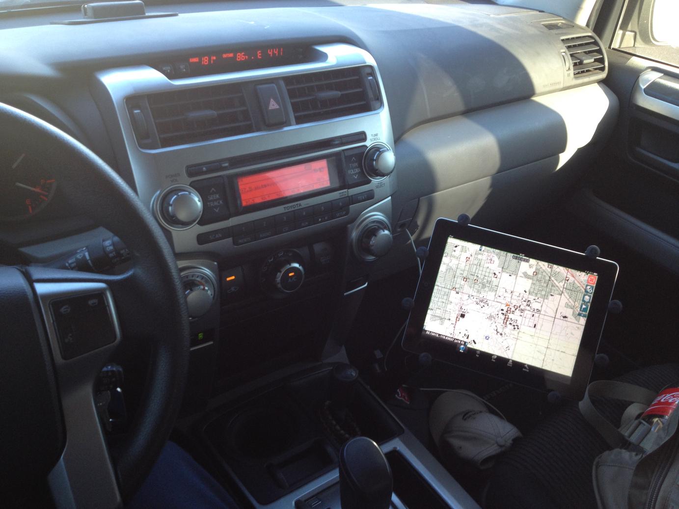

Having a no drill requirement might limit your availability. [MENTION=6163]phillyd2[/MENTION] and myself have used a ram mount and not the universal one. I had an idea and then saw his and he lead me in the right direction and it fits all your needs but the no drill, in the photo it looks like it is in the passengers way but it is vertical with the side console and in no way does the passenger touch the arm of the mount... Let us know what you find though

I haven't ruled out the arm mount that will bolt onto the seat bolt. That is still a viable option for me, glad you included that, and also the fact that it doesn't interfere with the pax legs etc. I prefer that style of mount. Ram has a selection of mounts that will go under the seat bolt, it's one long goose neck vice the adjustable arms system like what was pictured. Of the two, I can see positives in both the flatter console mount, and the more upright arm.

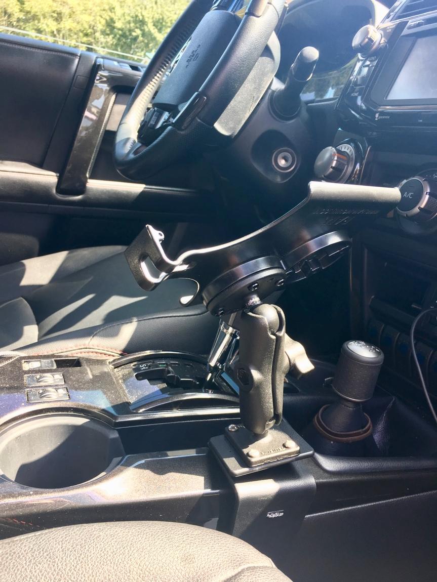

I have the RamMount X-grip with the seat bolt arm & I really like it.
I have one on driver side for my phone & one on the passenger side for the ipad mini. Its visible when I need it & it doesn't interfere with the passenger's legs.
It did take some maneuvering to reduce the vibration, but it can be done. Before i bolted the arm down, I "over-bent" the arm so that most of it is pressing against the console once tightened up.
ETA: I also cut about 4 inches off the metal rod to achieve the height I wanted. Make your bends at sharp angles rather than curves. Both of these tips reduced vibration greatly.

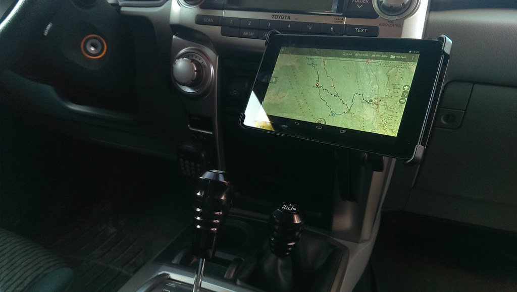

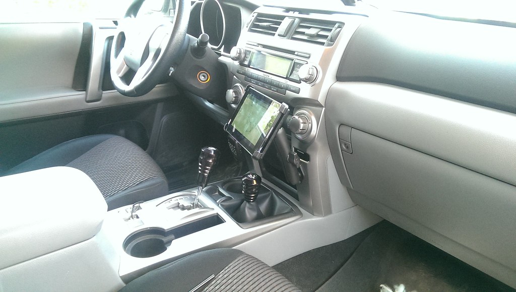

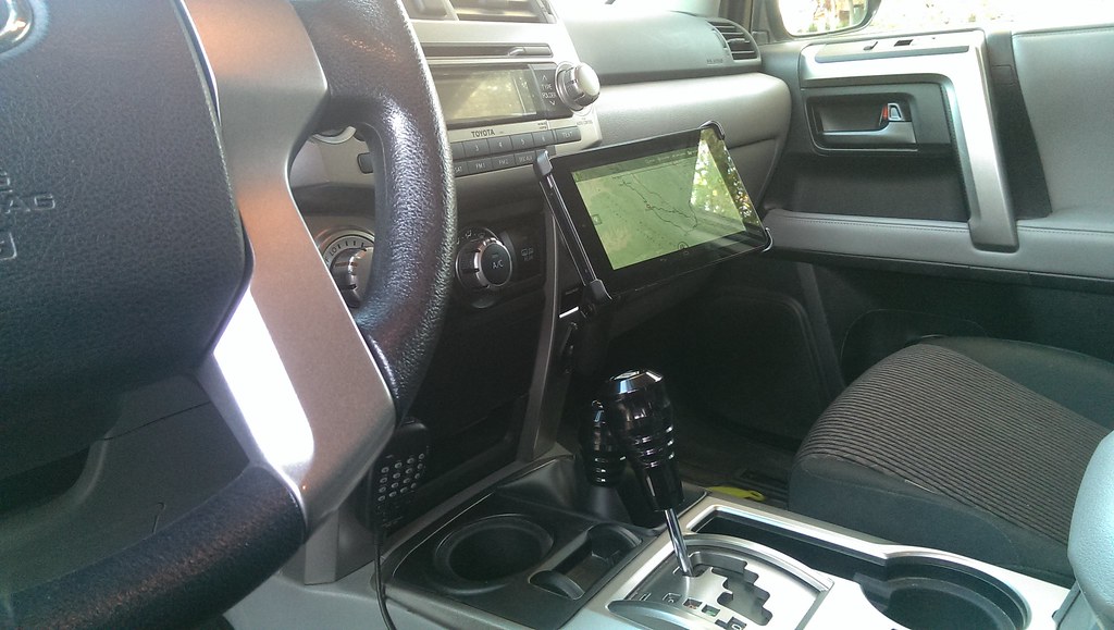

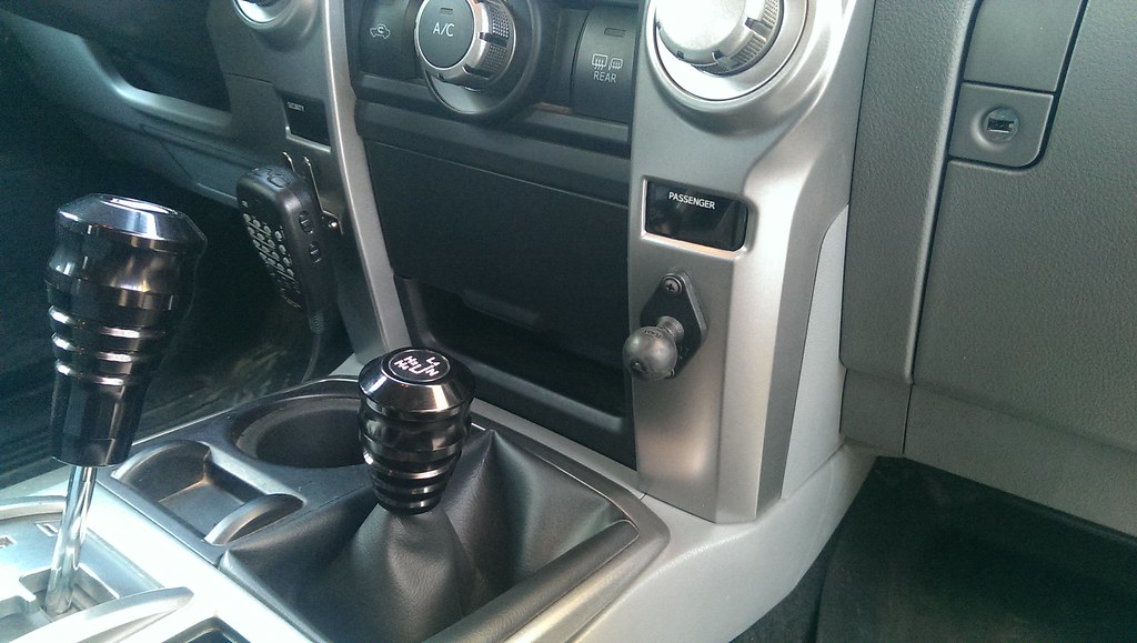

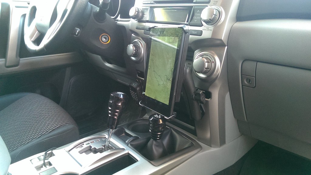

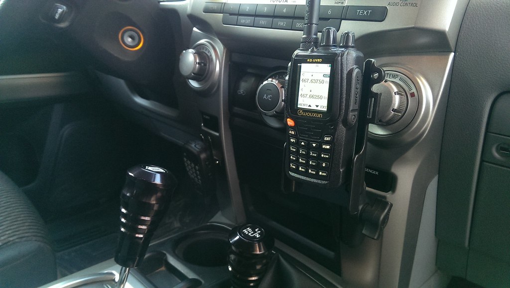

Here's some pictures of what I've done. Essentially I've hard mounted a 1" ball with diamond base, that I use to hold both my HT and my tablet. When not in use it's small and unobtrusive and you don't even know it's there.
All RAM Mount parts, and if you're interested, the part numbers for the Tablet assembly are at the bottom of the post after the pictures:
RAM-B-101U-C: Double socket arm with 1" B size(1" socket), 5.2" socket to socket length and two round AMPS pattern bases.
RAM-HOL-TAB-SMU: RAM Tab-Tite Kit for 7" tablets.
RAM-HOL-ROTO1U: RAM Roto-View adapter.
RAM-B-238U: RAM 2.43" x 1.31" Diamond Ball Base with 1" Ball and AMPS compatible hole spacing.
