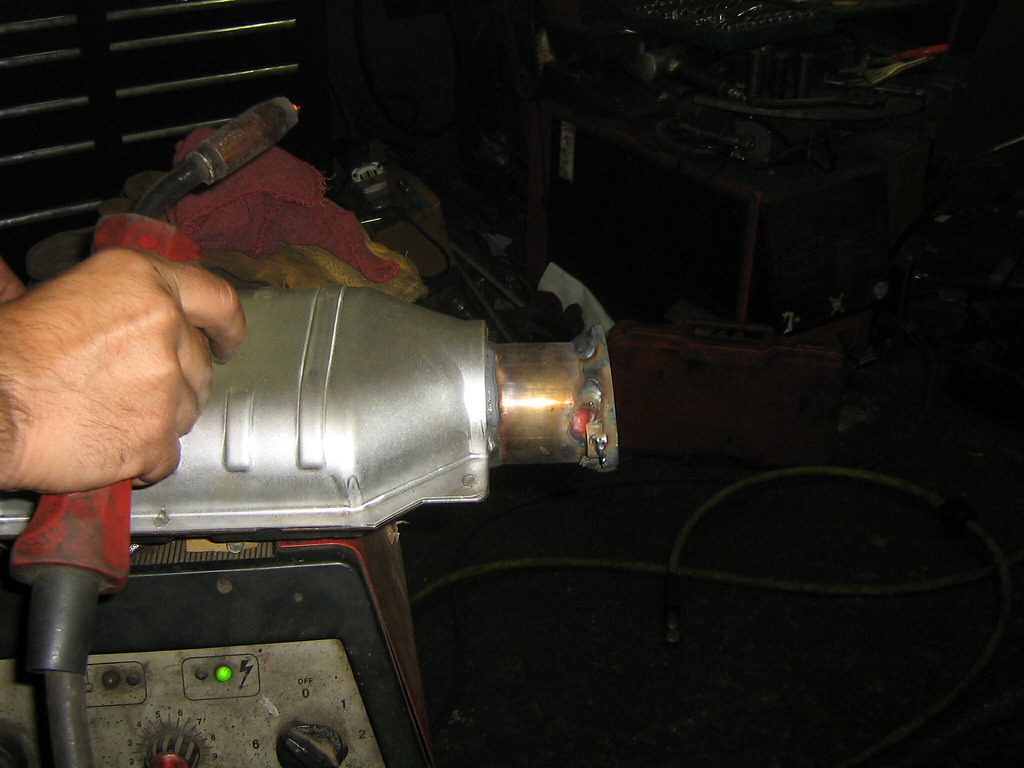

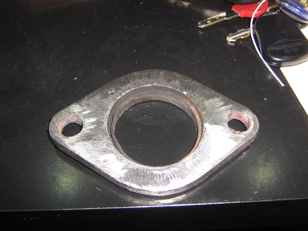

My Magnaflow HF cat flange didn't line up with the Doug Thorley flange so we cut the flange off my OEM cat & welded it to the MF & was good to go.
IMG_0906 by Mike Campbell, on Flickr
IMG_0905 by Mike Campbell, on Flickr
