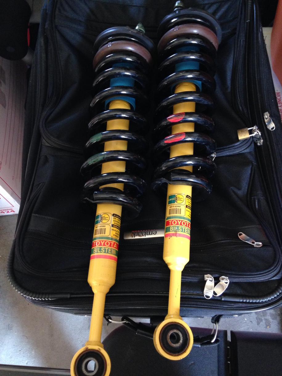

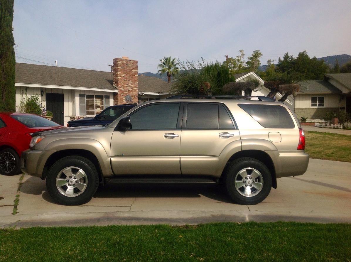

Installed trd tacoma front coilovers . A nice and cheaper alternative to fj coilovers. Leveled out my 4runner and rides awesome.

Nice I'm looking for this same set up. What did you pay. I am looking to pick up a 2012 complete bilstien set up with 80 miles to replace my 165k mile xreas for 200 shipped. The fronts are still assembled so I'm thinking it would be a decent deal
was there any modifications at all to make them fit, or do they bolt right in? When my xreas go I want to do something like this or go the fj 5100 route.
I got mine for 100$ trd sport . Very nice ride and levels . Rear is stock.
Did you happen to take before and after measurements?
Unfortunately not but since I had the tokiko shocks before my ride was waaaay nose down. Now it sits level. I think this is better than an fj because it's much cheaper and it's readily available . Just get the trd so it has bilstein
Not sure on his but from what I've found 05-up taco front is a direct swap for 4th gen 4runner and the back shocks will fit if you swap out the lower bushing.
Ur right. 2008 4runner 2011 taco coilovers with 3000 miles before owner installed icon .
