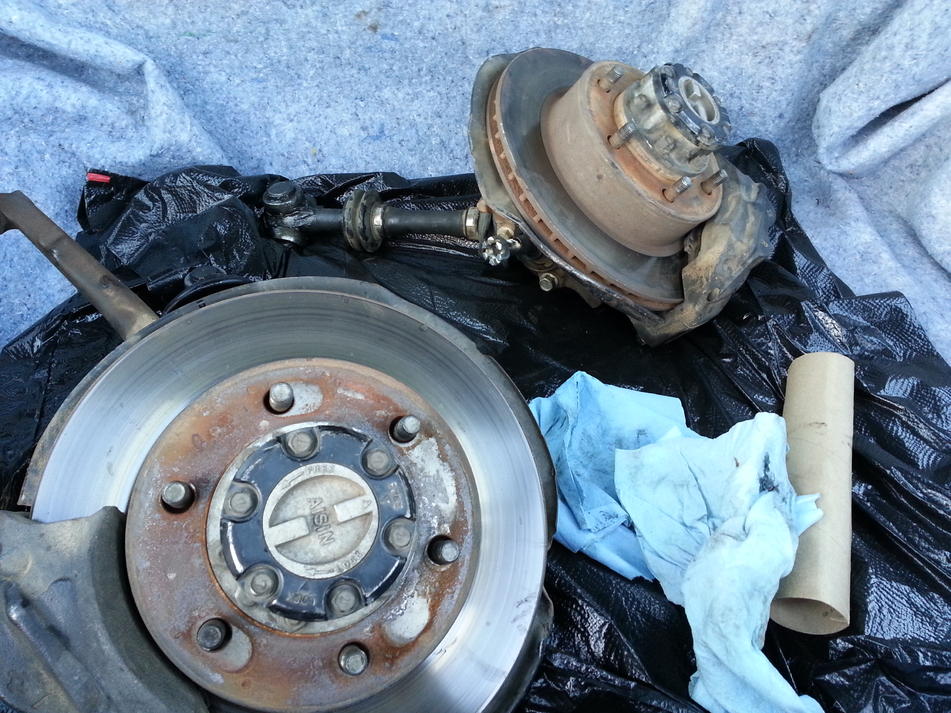

I finally got the parts needed to do the swap,could someone tell me what i need to replace and maybe pics would be nice.i know there is a tool needed to tighten the locknut.the front hubs did not have the ABS maybe he got rear only.Here it is in the back of my 60.:cheers:

Toyota lock nut tool PN- 648874 locknut tool-toyota
Got mine on amazon.
Change your UBJ, LBJ, definitely.
Anything else is up to you.
