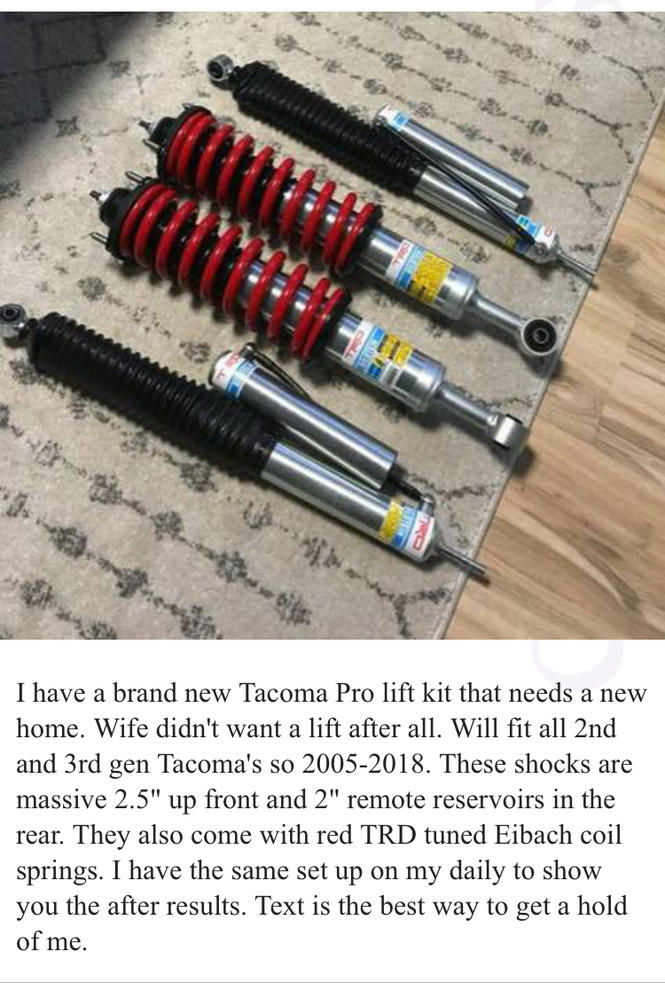

Would this suspension setup fit on my 3rd gen, and if so, how much lift would the front coilovers give?

That would be awesome if they fit! I just thought the rears were incompatible because of leaf springs vs coils. Keep us posted.
The front struts would be the only thing not usable. If the springs have a normal bottom seat for the perch you could install them on to Tundra 5100's and use them. Presumably the TRD Pro springs are progressive coils. If they're not it's not really worth messing with, at 800$ you could easily piece together a kit that would work just as well.
