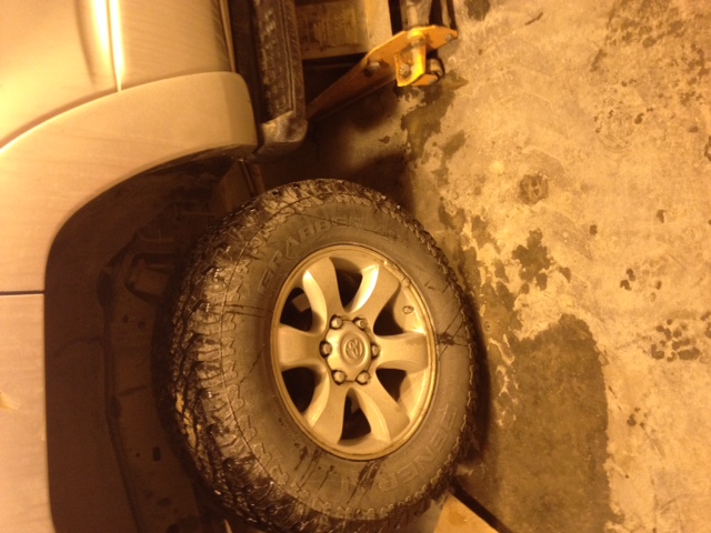

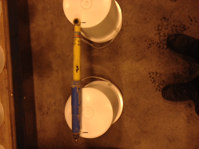

I took a few measurements this morning. I jacked the corner up so I could get full extension of the shock. My measurement from the bottom of the top washer to the center of the eyelet on the bottom was 22.5 inches.(truck xreas measurment) The Bilsteins I want to install are 23 inches. So I think a half inch is not going to hurt anything. So am just going to push forward and install and take the risk. By my measurements it should work. But by no means am I a mechanic, and I take no responsibility if it does not fit on your ride or if something happens if you do this install. Here in the pictures you see my truck lifted off the ground to get full extension of the shock, and the other pic is the bilstein shock where I took the measurements from. That is also the points I measured on the truck. See the black marker lines. Thanks for looking, please chime in if i'm off base here!

Just got my truck back from my buddies shop, seems to be good. Just have to change out the eyelet bushing. Good luck
