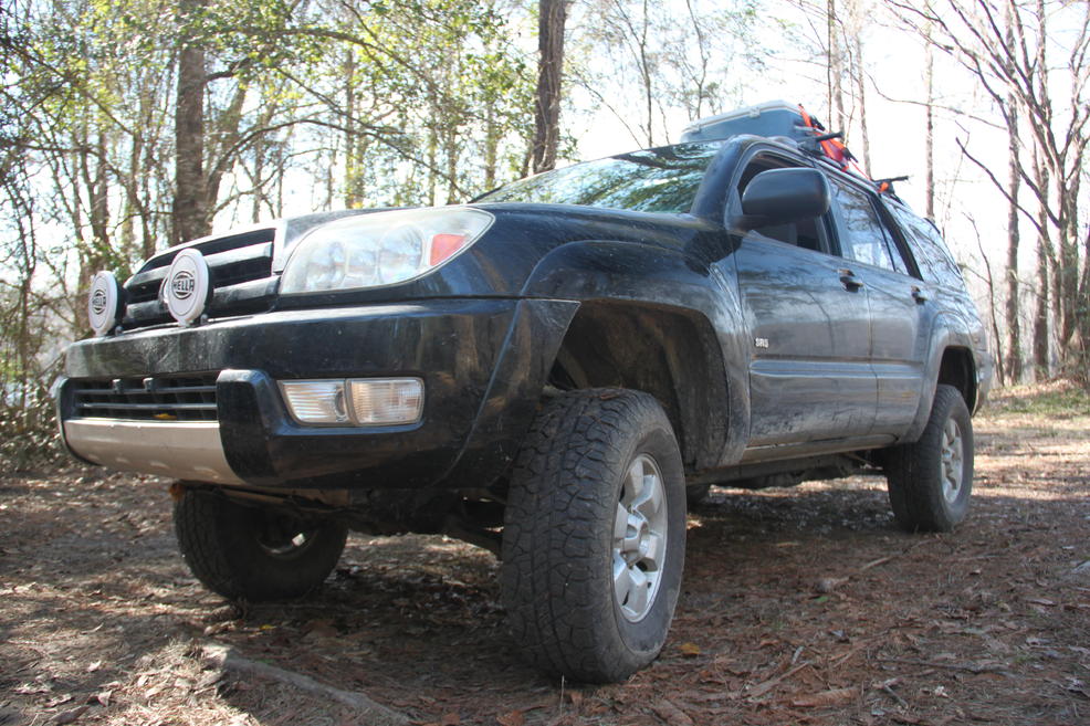

Fronts would fit fine, probably have to take off the daystar up front, would give you less height, but probably pretty good ride quality, I know [MENTION=87687]LTDSC[/MENTION] ran them for a while. He probably knows better than I do. The rear shocks only work if you change out the lower bushing, I did run a set of those for 10k miles.
i ran the Tacoma struts with a 2.5" leveling kit. Worked great and gave me great height.
How much lisft were you getting out of just the Tacoma struts and were you using the 2.5 daystar spacer and if so how much did you get in height?
2012 trd tacoma coilovers and a 1.5 inch spacer , 1.5 inch rear daystar spacer

Pic in sig.. 2014 Tacoma swap
Daystar 2.5 up front
Ready lift 2.0 rear
Doing this setup got me about 4 inches of lift in the front and 2 in the rear with the taco swap

Did you use the Tacoma shocks on the front and the rear? Do those shocks work alright with the added lift? Thinking about going a little higher than just the 1.5" front lift from the Tacoma struts but don't want to over extend the shocks
The taco swap will steady give u an inch of lift alone or so.. If u go any higher than what I have u will need to step it up to an icon package or somthin like that.. U need to get different upper control arms.
Yes taco swap all around.. Rides great. Check my threads for more info/pix

I did the Tacoma parts swap and some FJ rear springs and got about 1" in the front, maybe 3/4" in the back. I'd like just a bit more lift/clearance too so I'm considering a spacer lift on top of those parts. I've been reading a variety of threads trying to figure out how far I can go without needing to swap out UCAs.
Anything over 2" and you should replace the uppers otherwise you won't get proper caster adjustment when having it aligned. You want 4* caster or as close to it as possible. I can tell you at 3" with stock uppers I got 1* and that was maxed out.
