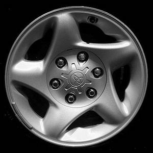

Hi again! Ok, I recently made another post about trading my rims and tires for a set of stock T4R/Tacoma/Tundra rims/tires and Ive got an offer for a set of 02-04 tacoma rims/tires. Before I get lashed by fellow forum members, I did take some time and do several searches for pics and info on this forum but I did not find much info. So.......does anybody have any pics or links of pics of a 3rd gen with the following rims on them and any info on how they will fit on my 3rd gen (in the other pic)? (16" w/ 265/70/R16) Thanks all!!!!!!

I had some Tundra rims from a 2006 (17" split 5-spoke). They worked fine, but they did seem just a TINY bit sunken in. The offset is higher in the Tundra/Tacoma rims, so it will look like your wheels are pushed into the vehicle---not a good look. You can get wheel spacers, but personally, I will never use them, because of safety and the hassle.

Anyway, the Tacoma rims are still at a higher offset (4.5") than the 4Runner(4.375"), so it will still look pushed in, especially if you have flares.
And also, why are you looking at those wheels? Personally, I think they look really bland. I'd rather roll on some black steelies than those wheels.
